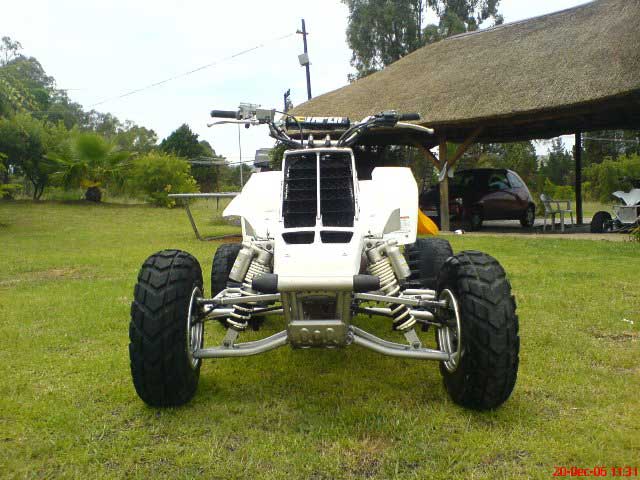

airtite Posted December 20, 2006 Report Posted December 20, 2006 Thanks for the post I did mine yesterday, it took me about an hour, I used some washers as a spacer but I am getting some aluminum spacers made up Quote
smokin 2 stroke Posted December 20, 2006 Report Posted December 20, 2006 ^^^^^very nice mgreat job mann^^^^^^^...........how u like the ride Quote
chevy7398 Posted December 20, 2006 Report Posted December 20, 2006 to the guys that have done tihis doeas anyone have ecact before and after measurments as far as width and and does it move the wheels forward or backword, and most important ground clearence loses or gains and total travel??? Quote
tmac20031 Posted December 20, 2006 Report Posted December 20, 2006 (edited) Im surprised that noone has addressed this but it seems like it sits alot lower. Wont it bottom out on large jumps. I mean its for mx purposes and there are large jumps on alot of tracks. It seems to me that the bottom of the bike would hit the ground on those jumps. Edited December 20, 2006 by tmac20031 Quote
smokin 2 stroke Posted December 20, 2006 Report Posted December 20, 2006 IM NOT AN EXPERT BUT OF THE SHOCKS WERE SET UP RIGHT IT WOULDNT RIGHT... Quote
Mullet Man Posted December 21, 2006 Author Report Posted December 21, 2006 Thanks for the post I did mine yesterday, it took me about an hour, I used some washers as a spacer but I am getting some aluminum spacers made up looks good man. :thumbsup: also looks like you have some adjusting to do on the shocks to raise it up a little bit. yours definately sits lower then mine does. also, your tie rods look to be at a different angle as well. what spindles do you have on it? what are all the parts you used? Quote
Mullet Man Posted December 21, 2006 Author Report Posted December 21, 2006 (edited) I was thinking the same thing. It looks like the frame would scrape the ground when landing from large jumps. Care to drop it from about 8ft to flat landing and see for us? i've only had mine up about 5ft. i dont MX or hit triples like you do lol but i havent had too replace any divets yet. i also weigh in at 210-215lbs! my shocks are still factory valving stock! the bike definately sits lower then with YFZ shocks and stock a-arms. and probably only a tad lower then with stock shocks and arms. the top of my gas tank has a very slight, read hardly noticeable upward slope, if that helps you picture it at all. some YFZ long travel shocks in the ~17-18" length would give you all the ride height you need. and you would still come out way ahead as far as money goes (used YFZ LT shocks go for around $600-$750). you are more then welcome too try mine on one of your triples :thumbsup: Edited December 21, 2006 by Mullet Man Quote
