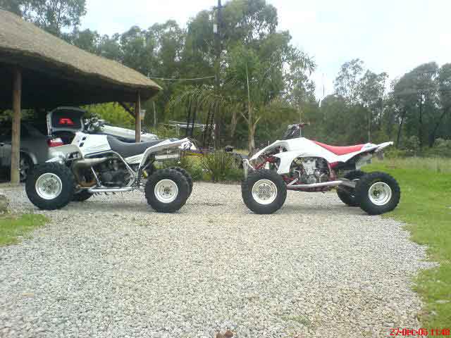

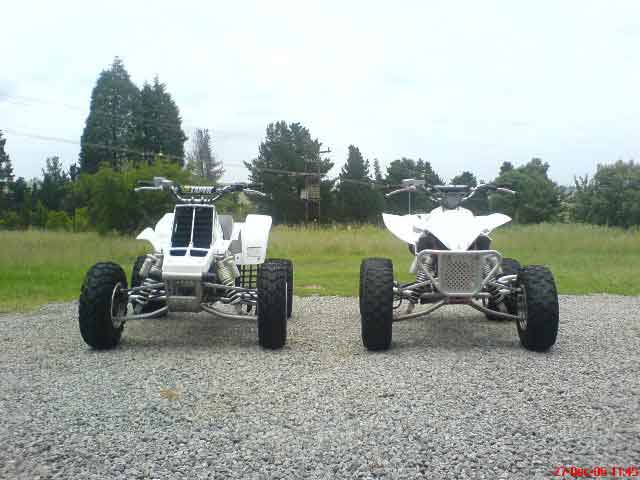

airtite Posted December 27, 2006 Report Posted December 27, 2006 awesome man! i am very happy that you are very happy!! :thumbsup: i would really really like to see pics of your Banshee with this setup next to your YFZ! as well as some pics of the jump you hit! here are some pics, I was wrong it looks like the shee is quite alot lower, but like I said it still seems pretty good on the track and with a little tinkering will be an awesome setup. Quote
WNARACE Posted December 27, 2006 Report Posted December 27, 2006 Just wondering if anyone has found a good setting for the preload adjuster? I started all the way down and am working my way back up. At the bottom you max out the suspension travel fully extended, and it is mighty stiff. Let me know where you guys like them. Thanks Quote
Mullet Man Posted December 28, 2006 Author Report Posted December 28, 2006 (edited) Just wondering if anyone has found a good setting for the preload adjuster? I started all the way down and am working my way back up. At the bottom you max out the suspension travel fully extended, and it is mighty stiff. Let me know where you guys like them. Thanks i believe mine has 14 threads showing. front pic thanks for the pics!! and it looks good :thumbsup: do you mind if i save your picture of the front shot and put it into the write up on the 1st page? Edited December 28, 2006 by Mullet Man Quote

squish Posted December 28, 2006 Report Posted December 28, 2006 Ah see the difference in the shock angle. The setup on the banshee has more leverage on the shock. More travel that way though. Quote
