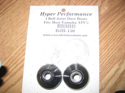

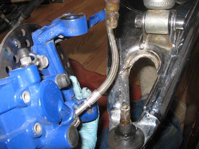

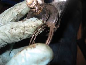

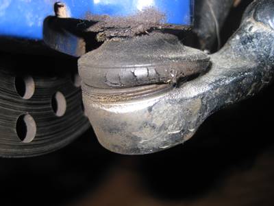

If you have cracked, worn, dry rotted ball joints this may help in replacing the boots and possibly saving you from a failing ball joint and the costly A-arm replacement. First off you will have to order some ball joint boots from somewhere. I got mine form Cascade Innovations for $15. After you get your new boots you will want to lift the front of banshee with a jack or something. Then you will remove the front tires and the tie rods off the spindles. Next you will want to remove the nuts holding the ball joints into the spindle, and then removing the ball joints from the spindle. You will then notice to what i believe is called a spring clip kinda looks like key ring that holds all keys together. I took a pointed finish punch for nails and got it behind the clip and ran it around the inside pf the clip to to remove it and the rubber ball joint boot. Once the boot is removed i cleaned all the old grease out of the ball joint and applied new grease in the ball joint. Now that you have put new grease in you can put the boot on. Since there is lip you have to get the boot over and there is grease on stuff now i used that punch again to help slide rubber boot into place. Now with boot in place you can put the spring clip back on the boot i used the punch again to assist the spring back into place. Since you have successfully got the spring back into place without damaging the new boot you are now ready to put the spindle back on the ball joints and tighten every thing up. There should be pics below for extra help. I did all four of mine in the matter of forty-five minutes to an hour by myself. This is real simple task to do along with it being cheap.

Thanks for the info i found them on cascade for $15 a set of 4 wasn't looking forward buying new arms
Got a set of stock A-arms on the banshee right noe and the A-arm ball joint rubber boots are dry rotted and cracked..... i just had the arms of cleaning everything up and the ball joints still felt tight and good i just want know if there is a way to replace the rubber boots.... to my knowlege you can't replace the ball joints unless you by new arms and that is not what i want to do right now
