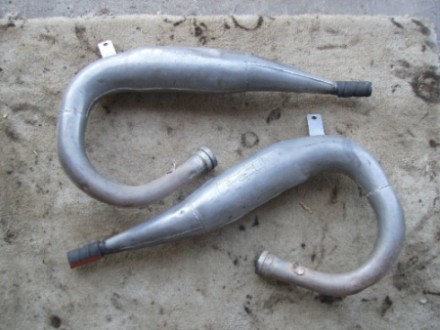

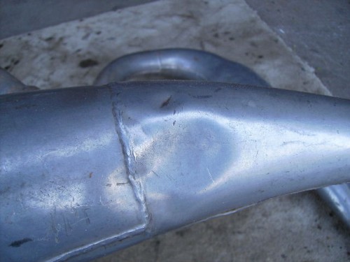

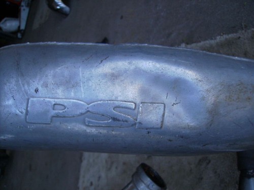

i have for sale, a used set of PSI pipes for a banshee. they make decent bottom-mid power, so they are oriented for a tight trail or woods type rider. they are ceramic coated and have a few dents. asking $125 OBO. here is a link to a dyno sheet of the pipes: http://www.angelfire.com/extreme2/yambanshee/techtips/pipes/psipipes.html

Ok guys. I tested the pipes tonight on my shee and there is no way that these pipes are like, or anywhere near CPI's. These PSI's are a bottom to mid pipe for sure. Top end isn't as good as my fatty's. I probably lost 6hp on upper mid-top, w/the PSI's, versus my fmf fatty's. The PSI pipes also fit for shit. The welds weren't bad, but the spring hook tabs were in crappy locations versus the fatty's. The PSI's would be a ok/decent woods pipe, but not a dune or open trail pipe. The PSI's were noticably quieter than the fatty's too. Needless to say, the fatty's are back on. Just thought I would share the info w/you guys. So, these pipes are now for sale, as they aren't for my riding style.

ok cool. yeah, i've been searching on google today for some more info on PSI pipes and found these 2 pieces of info so far.... http://www.angelfire.com/extreme2/yambanshee/techtips/pipes/pipeinfo.html http://www.atvsource.com/articles/product_reviews/2000/100400_psi_performance_banshee_pipes.htm
Hey guys, my little bro picked up a set of ceramic coated PSI banshee pipes this weekend at a local swap meet. I've never ran them before, or heard of anyone running them before, so has anyone on here heard of how good or poorly they run? how do you guys think they compare to my FMF fatty pipes or any other aftermarket pipes too for that matter? any info that you guys maybe have like a dyno sheet or something, or anything informative, would be more than appreciated. Thanks.
