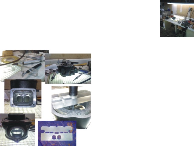

  18. You think I'd be better off with The OKO 28's Oh, and on that .PDF file there are 2 pages. The first one is blank. Don't know how that happened.

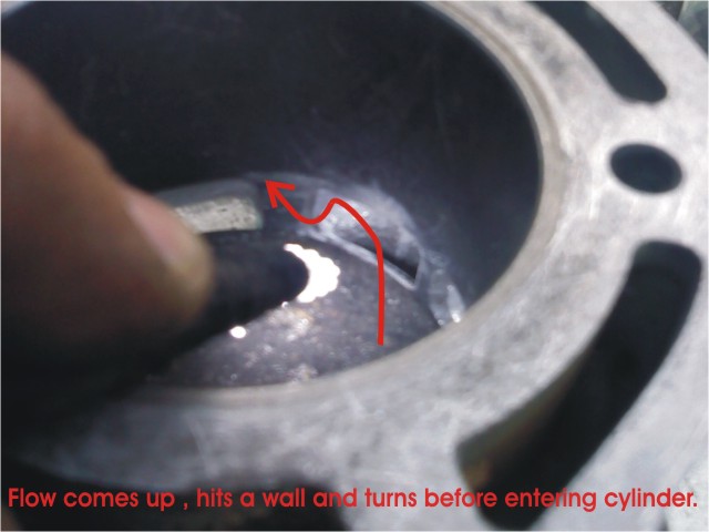

  20. OK I just decided to start reading this post and I can't believe no one has mentioned TEL. Tetra-ethyl lead is what was in most octane boosters back in the days and worked damn good until the FTC found out if you get it on your skin it will give you instant lead poisoning. As recent as 3 or 4 years ago there was still a brand of octane boost (can’t remember the brand) that still used TEL. Do a Google search maybe some better brands still use it. I know Shell, Sunoco, VP use it because it is the only way racing fuel is made, Unless of cores it’s unleaded race fuel. Here’s a question for you, Can you get E85 in your area? It’s about $2.20 a gallon in Columbus and it is 100 octane. of cores you will need to set your carbs up like alky carbs and you will get half the fuel mileage but did I mention $2,20 an gallon 100 octane? I’ve experimented with a 20% mix of E85 and 93 pump gas with great results you just have to go up 2-4 jet sizes with a 20% mix and be sure you are using Klots STP or beanol or an oil that will blend with ethanol.

  24. This is the secondary port back wall I am talking about.
