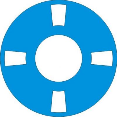

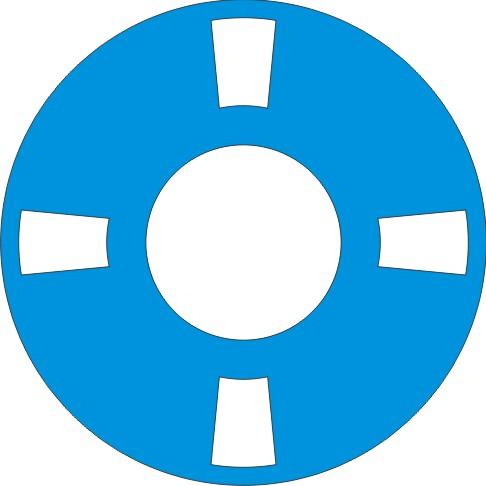

Rebuilding my clutch basket and found that paper gasket/shim between gear and basket is shot.
Where can I get one or what would be a good .020" sheet material to make one out of? I have a CAD/CAM router and have the part digitized and ready to go. I was thinking
just a piece of 2024-T3 aluminum.
Any thoughts?
