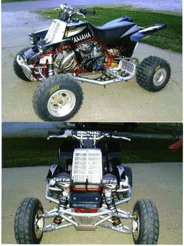

So I finally stuffed some other projects aside and pulled out the banshizzle for some much needed attention. The suspension gave me some hell (I had some wrong parts) but I got it ridable enough to do some tuning on it.
I bought a 2-1 from NYUK a few years ago and put it on my stock port 02 banshee along with a new set of reeds...its a Stage 4 intake & 38 PWK airstriker. I thought it was AWSOME, made it rip from the bottom like a 4 stroke. I got a MX port later on and the motor seemed faster but didn't feel like it was making the power it should. It was fast...just not fast enough, and the hit was totally gone....not a jump in power at all going through the RPMs
I'm not going into the jetting on this one as it would take a few pages to write up...I went through countless needle and jet combos trying to extract every ounce of juice I could.
So not being wowed with the performance when I parked it I picked up a set of 33PWKs set up by SUDCO & a noss head with 19s (my stock head is shaved 35 thou).....I bolted them up with some UPP intakes that came with the carbs and gave her hell once down the street with the jetting and needles that came in the carbs. HOLY CHIT! this thing is SO much faster than before...it comes on quick and rips the fronts off the ground. It's so much faster I fryed the clutch after just 2 rides down the street and I really couldn't get an idea of how high it's going to rev....but it's looking really, really good.
I just wanted to throw that out there because I see so many 2-1 questions on here, Im not bashing them, after all I own one :biggrin: .....but I am completely floored by the improvement & think I really just started to miss the power band I had when it was just stock with pipes & filters
fyi:
MX port
stock cages w/boysen reeds
ported UPP intakes w/crossover tube
uni pods
19cc domes on 100LL
T-5s
Big Radiator
Hit me up if ya want to buy a 2-1 with a 38PWK for cheap :thumbsup:
