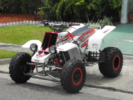

KandyTeal98 Posted April 5, 2010 Report Posted April 5, 2010 98' with 05 yfz arms and shocks,and +2 Banshee Full Flight Tie Rods! rides great will be upgrading soon to the spindles and hubs..etc... and maybe some longer shocks to raise it up a little but as of right now its AWESOME THANKS TO MULLET MAN FOR THE INSPIRATION!.... Quote
yamaholic125 Posted April 6, 2010 Report Posted April 6, 2010 i did this on my 87 and used YFZ spindles.... can a guy use banshee spindles? if so what length of shocks are needed to atleast retain OEM ride height? Quote
