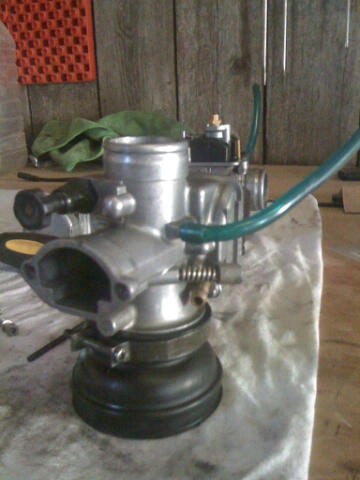

leak down results..... ANY IDEAS FOLKS?
thrill-billy85 replied to thrill-billy85's topic in Banshee Repairs and Mods
i really have no clue how to tell if theyre stroker domes. i ordered them from the local shop here, and they had called tucker rocky and they said they were out of 20cc, but they could send me 21cc domes instead. i said it's work. then when i went to pick them up the parts guy was like OH hey they sent 20cc domes! kinda makes me wuestion whether they are or not you know... -
good idea AK. i looked at them today, and one has been worn really bad on the curved side, near the bottom. the other too, just not as bad. the wear is near where it seats. i installed 50 mains today, and it helped.... ALOT. enough to where it was bearly doing it at all. i also havent put the air box back on, so i was basically running open carbs with a clean piece of t shirt rubber banded on the boots. i also took tha body that the jets screw into off the main body of the carb. the o ring seal had gummed up gas all dried to it. i guess ill see about a rebuild kit for it. also bad when i had put my cool head on (got the stocker on now) it struggled to get into the power band. went home, out the stocker back on, and ir ran fine. it seemed like it wasnt getting enough gas 1/2-3/4. do people often have to re-jet for just a cool head with 20cc domes. i was running 93 pump gas -
the carb slides APPEAR to be shutting all the way... never seen how its supposed to look on a pwk. the slides are non plated aluminium, and they are loose. there is plenty of slack in the cables. enough so i take up some before it actually opens up -
you know the slides als dont seem as snug as say the stockers. obviously its a completely design though. seems like the cable adjuster would let in WAY more air then a bad gasket would though... ive got a set of 50 pilots thatll be here monday. well see what happens. hey i also learned today it has an adjustable timing plate set at +5 degrees.. dont know if that matters or not. -
ok the mods: 99 shee .020 over stock stroke fmf fattys k&n filter, lid on box, no snorkel 28 pwks 140/45 (no oil injection holes to plug) +5 timing (didnt know this till today) 2800' facts/symptoms: idles high air screws all the way in idle screws all the way out exhaust is dripping black and dark gray oily shit and was before the new carbs compression 125/124. leak down test 6psi for 6-7 minutes.... ie no air leaks from the intake manifolds throughout plenty of slack in the cables, and no hanging slides. the slides are pretty loose like theres alot of play side to side the tops on the carbs are not the screw on type, and the gaskets look lke theyve seen their day. WHY DOES IT IDLE HIGH??? starts easy enough. was a 1 kicker with the stockers.... maybe 2 even now. anyone have an idea on float height???
i agree. and at 4000 feet, they might be too rich.... if it runs better as it get colder, youll know they were too rich. sputtering and poor power can often be attributed to it running too rich. maybe go a turn or half turn out of your air fuel screws see what that does
165/48 1.5 turns middle clip
yeah id hit up some 310 mains or even 320. remember if youre gonna ride during the winter, you should be putting bigger jets in anyways.
shit mine doesnt have the oil injection holes...... ahh well ill keep plucking away on it.gotta be jetting or an airleak somewhere.
hell, they BOTH sound lean to me....... or did. fuck i hope youre right. now i gotta just sit here for 4 hours and WONDER goddamnit
