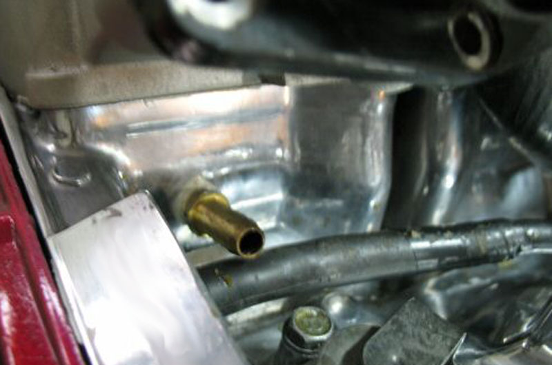

With the hoses or with out the hoses
FireHead replied to vainavic's topic in Jetting & Exhaust Forum
You hyave to make you own ports on the intake. You need some barbed brass fittings, a drill, and a tap. There are several places to drill on the cylinders for the vacuum ports. My personal favorite is under the intake tunnels in the upper case half. You can also put them in the intake tunnels themselves, there just won't be as strong of a vacuum signal on that side of the reeds. I attached a picture of what one of the ports might look like after you installed it. :thumbsup: -
Uhhhhh no. If they are Cheetah powervalves you need to have a port on each intake to connect the lines to. Those lines are what provides the vacuum signal to operate the powervalves. If you don't have them hooked up then your powervalves will always stay closed. I can only imagine if your power valves were closed all the time that your bike would not have any power and only be able to rev a little past idle before falling on it's face. -
