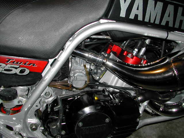

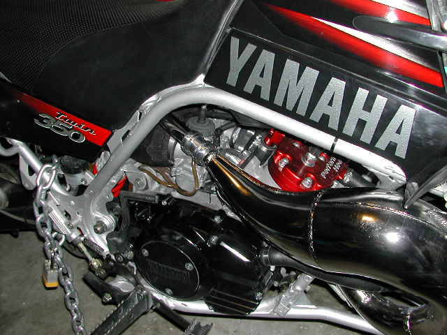

  21. i guess it's a little late now, i was taking pics before your last post. but here are some from modquad. they have an o-ring on each end and they screw together. i haven't ran them much yet, so i don't know how well they seal. before i screwed them together i put a couple of layers of hi-temp sealer along the pipe and stinger joint.
