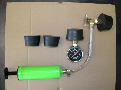

cam2 Posted May 12, 2007 Report Posted May 12, 2007 (edited) this is a home made kit that i put together and it worked great. i bought the plugs from the "ace hardware store". it takes a little effort to get them in the exhaust ports. but they'll go in with the aide of a screw driver. i don't recall the sizes, but the exhaust plugs are a little smaller than the intake plugs. i forgot to add the pic. here it is. Edited May 12, 2007 by cam2 Quote

cam2 Posted May 13, 2007 Report Posted May 13, 2007 (edited) yes the leakdown tester i have is for autos.it a snapon that screws right into the head.is it possible to do it this way?or am i going to have to adapt it to read from the intake port?will i get accurate readings if i use the adapter for the head? yes, it will work fine just as long as it doesn't leak air pressure and you plug off the intake and exhaust ports. use something like the rubber plugs shown in the pic i posted earlier. all you're doing when you're doing a leak down test is to make sure that the intake, combustion, crank, and exhaust area (minus carbs and pipes) of the engine don't have any air leaks that will eventually cause coolant, air, and or transmission oil leaks to get into the areas where they shouldn't. when you do a pressure test and unfortunately if the pressure drops significantly it will let you know if you have a intake gasket leak, a crank seal leak, a head gasket leak, or a cool head o-ring leak (if you use one instead of a stock head), a base gasket leak, etc, etc. Edited May 13, 2007 by cam2 Quote
