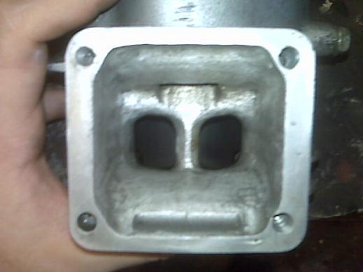

A: Bad reeds - I have Vforce 2's. How do you check to see if they are bad? Hold them up to light and see if you can see light between the pedals and the cage? I can see a little but not much. (can get pics if needed)
B: Port job - Apparently the guy who bored my cylinders said that they were ported "within an inch of their life." I have to agree with him on this one... the porting does look a little outragous. But would this cause hard starting? (can get pics if needed)

if it has been ported to with a inch of its life,then that could cause hard starting.(too high exhaust port) does it have any bottom end (off idle)? or does it rev like crazy ?
unfortunatly if it has to high exhaust ports there isn't a fix for that! other than new cylinders!

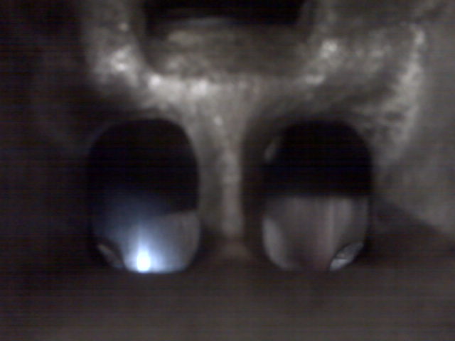

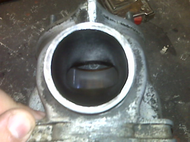

Here is the exhaust. You cant tell by the pic but someone has been in there with a dremel or something.
Like I said the pics arent the best.
