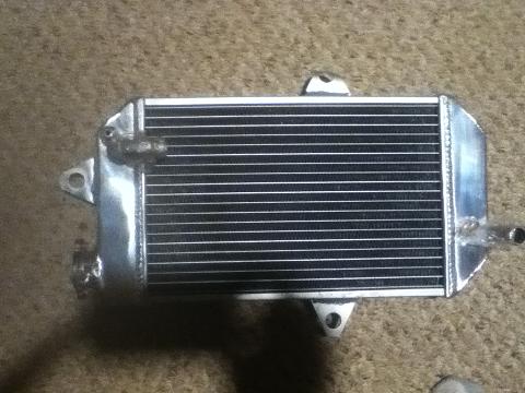

ebay $100 new oversized radiators are they wortbuying?
zr2highrider replied to Craig Walker's topic in Product Reviews
Got mine in tonight. Looks pretty good but one of my tabs is bent. I havent looked at my old one to see if its bent but it should be pretty easy to straiten out. As for the quality, welds look pretty good but I would definatly polish and put the stock cap on it. The new one looks nice but is a little thin for my liking and kind of a b*tch to take on and off. Anyone know what the stock cap is rated at? This one is 1.1. Cant wait to put it on and get riding again. Heres a pic.
