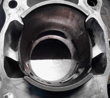

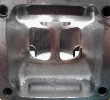

Ok, got the intakes and the bottom of the transfers done. Tomarrow the cyls go out to be bored. Here's a couple of pics, and Thank You for the help and the great feedback!
