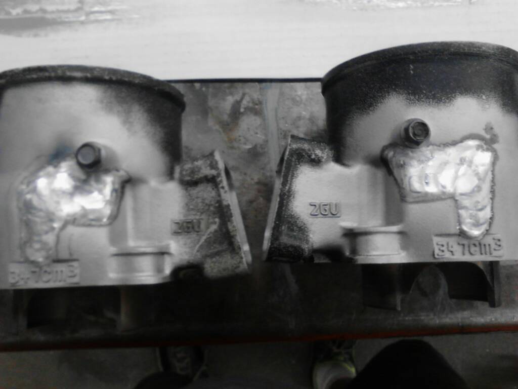

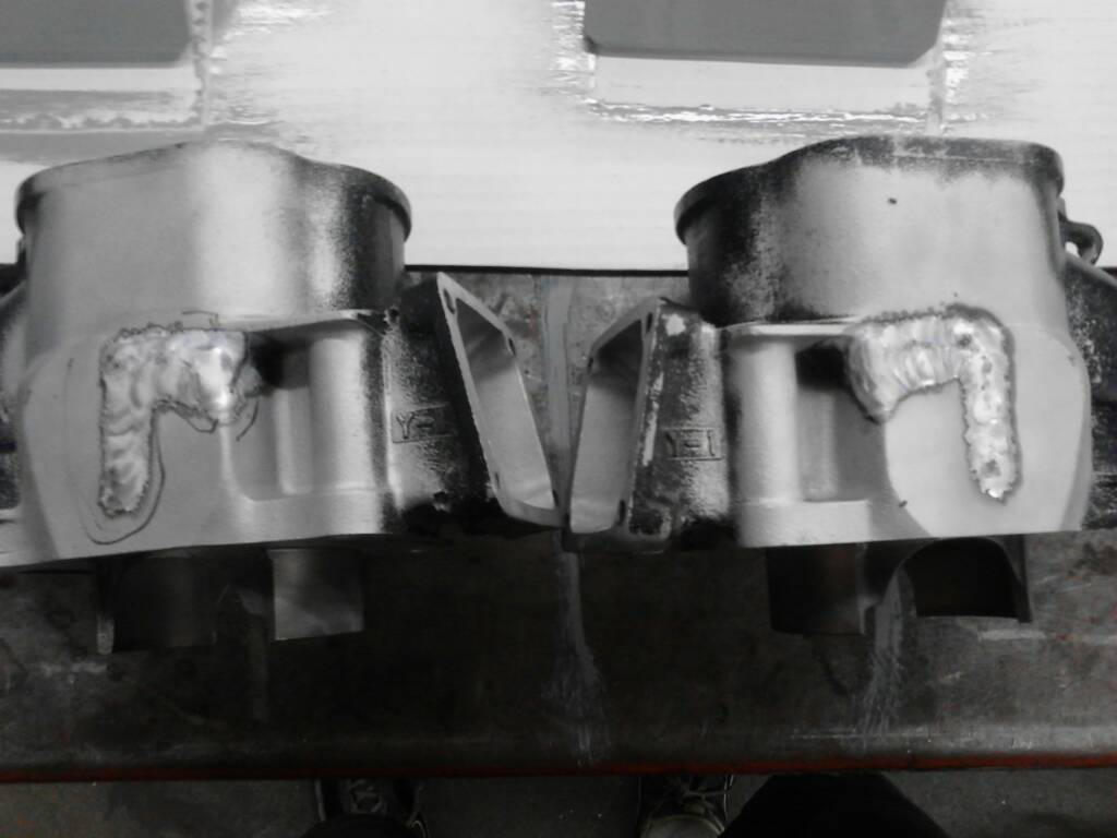

Just got the cylinders back from the welder. Basically just had some voids filled so I could work the transfers and not have to worry about popping through the casting.

There's enough there to get it rounded. The bridge is still the stock width, so putting a radius on the cylinder side edges, and still have enough support for the rings shouldn't be a problem.

There hasn't been anything else done to the cylinders since the pics I posted. There should be enough left on the bridge to rework it. With everything that I've been learning, there might be some welding going on. Mostly I'm worried about poking through the outer walls. I was working on a snowmobile tonight, a 600 twin Rotax. The intake layout... no windows in the piston, and the intake area is completely open into the transfers... just adds to the thought process.
