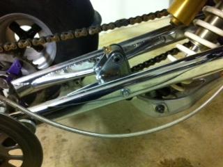

looking to trade a chrome 4" for a 6" swingarm
