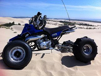

I come to the coast all the time. I usually ride my CRF 450. When I get tired of the that I head to the steep tree shots or Idiot holes right next to the water. This is what my banshee currently looks like. Soon to have white plastic with some paint.
