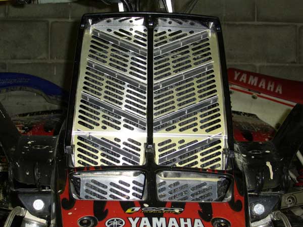

  12. Im not even sure where I got this picture, but I saved it cause I thought it looked badass. Now I cant find one like this anywhere. Anyone know? thanks

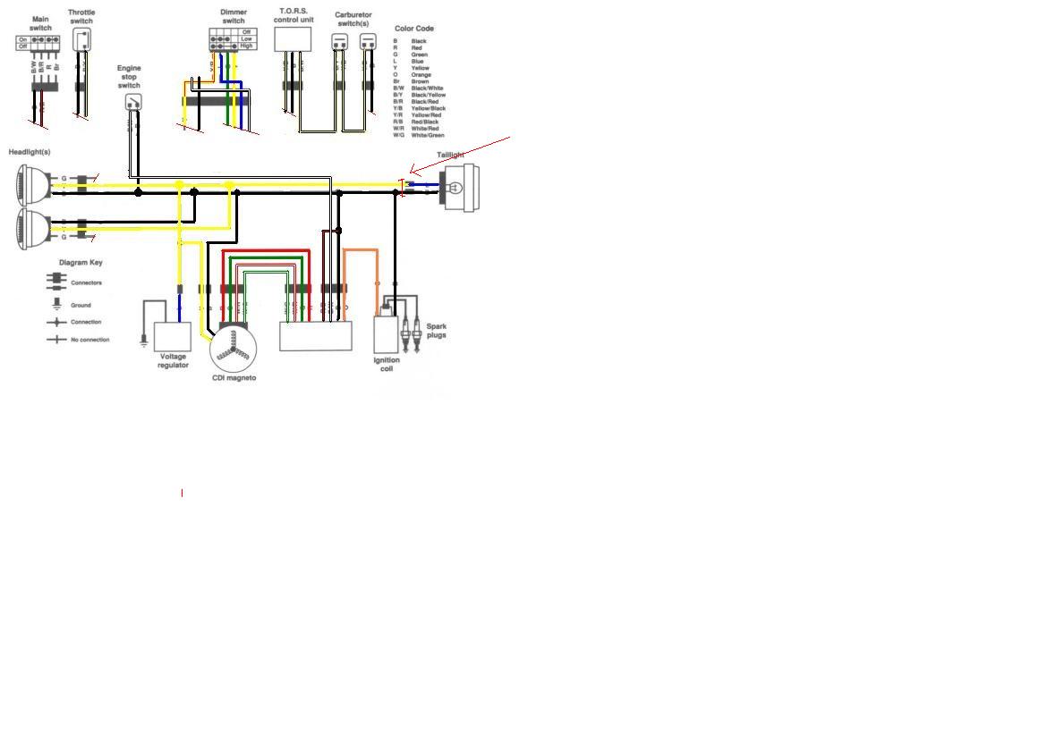

  18. Yeah I am wiring the headlights to just stay on when the bike is on. I know I can close the circuit up soon on the harness then in the picture, but I guess what I am making sure of is that I need to wire the yellow to the black. I know I need to wire the two yellows from the switch together but wasnt sure if the other part was necessary. I guess now that I look at it it isnt necessary right? I can just snip the yellow that runs to taillight and forget about it. If the black wire from the stator will complete the circuit. I think I am getting confused over something very simple
  19. Cause the bulb with power just completes the circuit so I could just complete it myself...make sense right?
  20. Ok, I am shrinking down my harness and I have cut out all of the tors and the kill switch. I want to just have the high beams on at all times. Using the electrical diagram from the FAQ's it shows to just run the lights to the rear taillight to complete the circuit. I dont have a taillight so could I just complete the circuit by splicing the yellow to the black? I drew a red line on the picture to show what I mean
