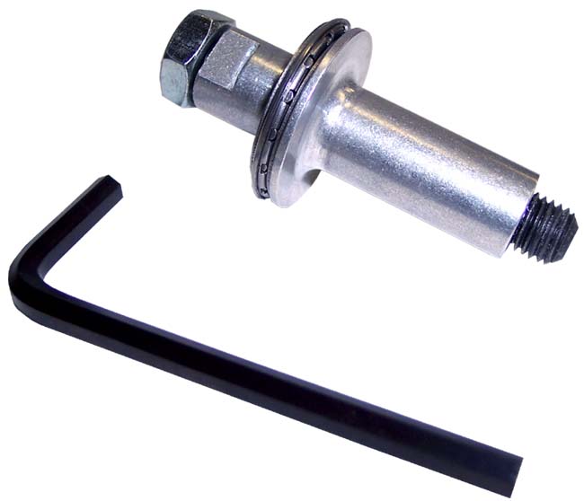

The clutch ball, rod and or actuator welded together. It depends on how bad it is. Most times you have to split the cases with out removing the cylinders to get the transmission out. If the rod is mushroomed then you have to grind it to get it out of the transmission shaft. I have done two in the last month. You have to removed flywheel, stator, clutch assembly then bolts and nuts. The using a rubber hammer split the cases.
