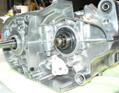

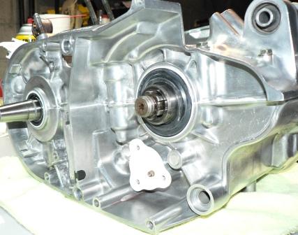

Thanks, not bad for my first time I guess. Use the finishing buffs dry (no polish). It took like 20 of them (at fuggin a buck fifty a piece) to do top, bottom, and the counter sprocket area. And try that Mothers Incredible Billit ($13 a can, but the shit is awsome), not the liquid stuff they sell for use with the Power Ball. BTW- dont forget to wear safty glasses and a dust mask, shit flies everywhere...good luck, and take your time. Any questions, hit me up. :thumbsup:
I did kind of a half-ass'd polishing job on my case while it was apart this winter. I used a dremel with the extension wand and the little 512E finishing buffs (about 20 of them) to start. Then I just used the small Mothers power ball and some Mothers Incredible Billit to bring a nice deep shine. I could have spent more time on it and got better results, but it looks ten times better than it did.
