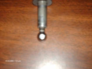

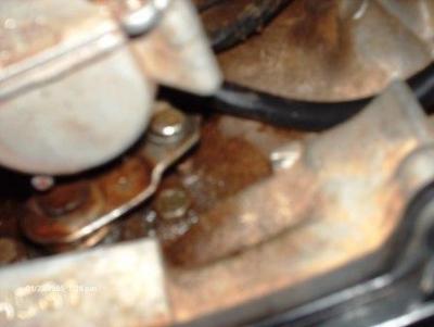

TexasBansheeMan Posted November 11, 2007 Author Report Posted November 11, 2007 I am far away from the basket all i have left is the Long rod and the pull lever on top of the case. I am trying to unjam the lever. the long rod has mushroomed from what i can tell. i have bout a 1/4 inch movement in the lever and bout an 1/8 in the long rod. The ball and short rod adjuster havr been removed. Quote
locogato11283 Posted November 11, 2007 Report Posted November 11, 2007 might as well just forget it. youre gonna have to split the case im betting. Quote
alcoholbanshee Posted November 11, 2007 Report Posted November 11, 2007 Thanks for the input guys! I am still tryin at it from the top I dont want to split the cases. I just got back with 2 36" prybars. I will let you know the outcome. Dude give it up....split the cases!!!!! I cannot think of any application on a Banshee that would require a 36" prybay......Let alone 2 of them. If you don't stop now you will screw something up. Just split the cases and be done with it!!!! It really is not hard. As mentioned above, it can be done in very short order. Quote
TexasBansheeMan Posted November 11, 2007 Author Report Posted November 11, 2007 (edited) Ok Ok after a few trys and not much luck I am going to try to split the cases. BUT IN EVERY TEARDOWN i have read all the linkage must be removed first. I am going to try tomorrow but I still have doughts seing how the linkage that goes through the top of the case is stuck from underneith. But thanks for all the info my fears have turned more to sadness and the sadness to pain MY BABY IS HURT!! she has many good seasons and never left me stranded. she is a 2001 and she has had. 2 topends <-not needed just done, 2 clutches,10 rear tires, and umteen oil changes thats it! I dont wanna do open heart on her but tomorrow she goes in the shed for surgery. :ermm: Edited November 11, 2007 by TexasBansheeMan Quote
