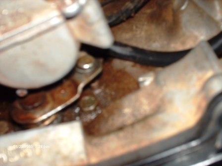

TexasBansheeMan Posted November 9, 2007 Report Posted November 9, 2007 (edited) Ok so He pulled the clutch and rode it for 1/4 mile or so then came back Like your clutch broke.:mad: WHAT?!? I grabed the lever and ROCK SOLID!!:mad: So I tore the cover off and as your guessed the ball and rod are one so i got them out now my lever is still stuck!! I can see on the ball here it tried to weld on both sides!! Any ideas on how to fix this? NE ONE IN HOUSTON TX WANNA COME HELP? I have never split the cases before and I dont want to fuck this up. please help. PICTURES of what your sayin will HELP LOADS!! Edited November 9, 2007 by TexasBansheeMan Quote

TexasBansheeMan Posted November 9, 2007 Author Report Posted November 9, 2007 ok I am downloading some pisc now. Kinda shitty but its all i got. All I can get out is the Ball and rod with the nut. I will be puting a pancake bering in and a ceramic ball, But first I got to get my lever un stuck I NEED HELP!! Quote
TexasBansheeMan Posted November 9, 2007 Author Report Posted November 9, 2007 (edited) Some pics of what i got. This is what I got out and the lever is still solid. I can see a rod inside the clutch end is welded as well Edited November 9, 2007 by TexasBansheeMan Quote

TexasBansheeMan Posted November 10, 2007 Author Report Posted November 10, 2007 Anyone got any ideas? I can get a magnet on the ro but it will only move bout a 1/8 inch. I can feel it clickin in the clutchcable when i move the rod. PLEASE HELP!!! Quote

TexasBansheeMan Posted November 10, 2007 Author Report Posted November 10, 2007 THANX MAN :biggrin: :thumbsup: I started Trying to get the Aligenment lever out of the case and no such luck. Its hung up harder tha a $2 buk f@*k in china town! ANY IDEAS i have to get this out before i can split the cases. There is no way it can be this hard!! Quote

TexasBansheeMan Posted November 10, 2007 Author Report Posted November 10, 2007 ok so I have been hard at it and i still cant get the dajustment lever out of the case. I can get it to come up some than its hung. Is orentation important? It will move just the smallest bit back and forth but when i come up on it It just hangs up. Anyone ever faced this? P.S. I have been at it with.. prybar,hammer,18 nail bar, screwdrivers. I am no puss I got bout a buc ninty five on the hoof so Its GETTN BEAT ON. Quote

RIPRuck Posted November 10, 2007 Report Posted November 10, 2007 Just split the cases.. you'll see whats going on with that arm cause its prolly mangled. You can still split the cases with it in there and then inspect it. Quote
locogato11283 Posted November 10, 2007 Report Posted November 10, 2007 will the clutch arm twist? if so, the rod is probably all fucked up in there and not letting the arm come out. if it wont twist you could have welded the rod to the clutch arm. either way its gonna be a motherfucker gettin it out. Quote
