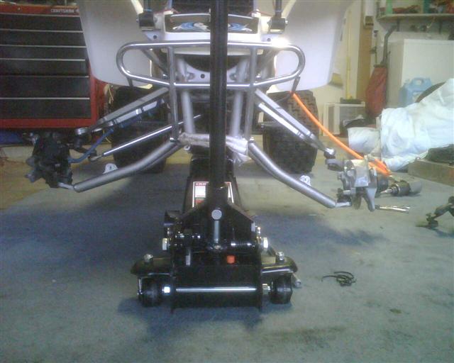

03bansheeLE Posted April 5, 2009 Report Posted April 5, 2009 I dont mean to hijack the thread but figured this is related. I just bought some 450 a arms but havent recieved them yet and I've read that the stock ball joints will bind if the suspension is allowed to move further down than the 450 shocks will allow such as with aftermarket shocks that are longer. By looking at pictures it appears that it is the uppers that will bind because the banshee spindle is designed for ball joints that are installed on the end of an arm that is bent up like a banshee stock a arm, whereas the 450 upper a arms appear to be almost straight so the ball joint is on a different angle. The lower ball joint looks like it is on the same angle as one in a banshee a arm so it should have no problems right? I was thinking of taking the stock banshee spindles and heating the upper ball joint mounts and bending them upwards a bit to change the angle to that of a 450 spindle. Im sure if you let the spindle cool off slow enough and then bake it in an oven to normalize it you shouldnt have any problems with hardening the spindle and making it brittle. I know you can just buy yfz spindles and hubs but I thought of just trying this, I like to try and make things work instead of replacing them and im on a limited budget, any input or ideas? Quote
88-04banshee Posted April 5, 2009 Report Posted April 5, 2009 I dont mean to hijack the thread but figured this is related. I just bought some 450 a arms but havent recieved them yet and I've read that the stock ball joints will bind if the suspension is allowed to move further down than the 450 shocks will allow such as with aftermarket shocks that are longer. By looking at pictures it appears that it is the uppers that will bind because the banshee spindle is designed for ball joints that are installed on the end of an arm that is bent up like a banshee stock a arm, whereas the 450 upper a arms appear to be almost straight so the ball joint is on a different angle. The lower ball joint looks like it is on the same angle as one in a banshee a arm so it should have no problems right? I was thinking of taking the stock banshee spindles and heating the upper ball joint mounts and bending them upwards a bit to change the angle to that of a 450 spindle. Im sure if you let the spindle cool off slow enough and then bake it in an oven to normalize it you shouldnt have any problems with hardening the spindle and making it brittle. I know you can just buy yfz spindles and hubs but I thought of just trying this, I like to try and make things work instead of replacing them and im on a limited budget, any input or ideas? I see your way of thinking and you are correct on the upper being the problem however i would be a little iffy on heating up the spindle it could make them weaker and not worth the money you can find spindles for. i ran my 450 arms/shocks for a couple weeks and had the chance to test it at glamis and was very happy but i would like to bring it up a bit so i found a set of complete 450 spindles,rotor,calipers and hubs for $70 shipped now i am looking for longer shocks, here is a picture after swapping one spindle over to the 450 (right in picture) it gives me about 3 more inches of travel not to mention another benefit is the much better dual piston brakes. now with that being said just using the stock 450 arms/shocks is a great improvement over stock and i would have been more than happy with that but thats not me. Quote
doorslammer Posted April 5, 2009 Report Posted April 5, 2009 (edited) damn thats a big difference,im runninf the 450 spindles and am considering getting some fox shocks for the front. what suspension are you planning on using? also, thanks for the spacers brian, bolted up perfect! Edited April 5, 2009 by doorslammer Quote
88-04banshee Posted April 5, 2009 Report Posted April 5, 2009 damn thats a big difference,im runninf the 450 spindles and am considering getting some fox shocks for the front. what suspension are you planning on using? also, thanks for the spacers brian, bolted up perfect! Yea i could not believe the difference either, as far as my set up i will be keeping the yfz arms now that i have the spindles and noss tie rods but i will be changing the shocks. fully dropped it measures a little more than 17.5 inches so ideally i am looking for a shock no more than than 17.0 i am kind of bum because i found a guy locally that has a couple pairs of brand new nice can-am rez. shocks but they are 18.5 inches so i think it would put to much stress on my ball joints when i jump i thought about adding 17inch limiting straps but i think it would sit to high so the search continues hell since i plan on keeping this set up i might even just bite the bullet and by a new set of works. Quote
2003LimitedBanshee Posted April 5, 2009 Author Report Posted April 5, 2009 damn thats a big difference,im runninf the 450 spindles and am considering getting some fox shocks for the front. what suspension are you planning on using? also, thanks for the spacers brian, bolted up perfect! Glad to hear they worked out for you and made it across the ocean fine! Yea i could not believe the difference either, as far as my set up i will be keeping the yfz arms now that i have the spindles and noss tie rods but i will be changing the shocks. fully dropped it measures a little more than 17.5 inches so ideally i am looking for a shock no more than than 17.0 i am kind of bum because i found a guy locally that has a couple pairs of brand new nice can-am rez. shocks but they are 18.5 inches so i think it would put to much stress on my ball joints when i jump i thought about adding 17inch limiting straps but i think it would sit to high so the search continues hell since i plan on keeping this set up i might even just bite the bullet and by a new set of works. Limiting straps would be a good idea, I might look into that for my new YFZ450R shocks. I actually like the idea of limiting straps, that way neither the ball joints or the shocks and providing the limitation on the suspension. Quote
