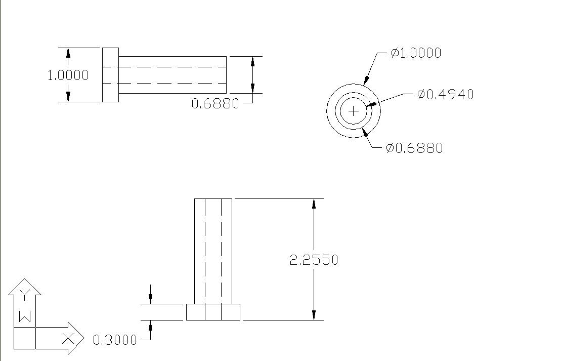

ajl12 Posted December 31, 2008 Report Posted December 31, 2008 has anyone got the specs on these spacers? just got some a arms. Hopefully I can get them machined as one piece. Quote
98_banshee_newbie Posted December 31, 2008 Report Posted December 31, 2008 here are the blue prints. Quote
peterlocal22 Posted December 31, 2008 Report Posted December 31, 2008 here are the blue prints. great blue print Quote
98_banshee_newbie Posted December 31, 2008 Report Posted December 31, 2008 I got it from speedy2222 so props to him Quote
