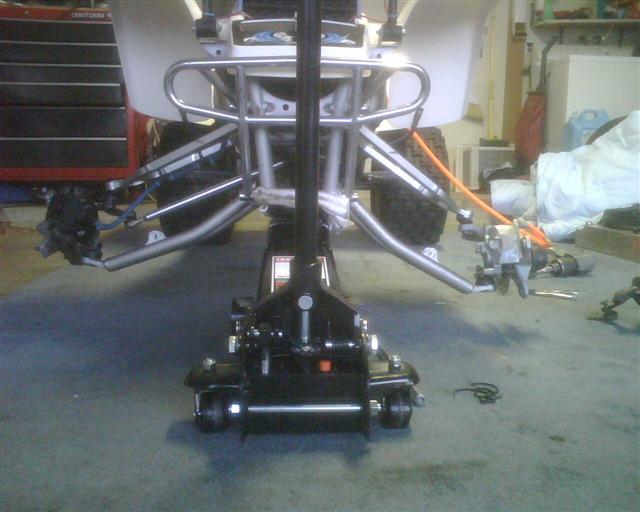

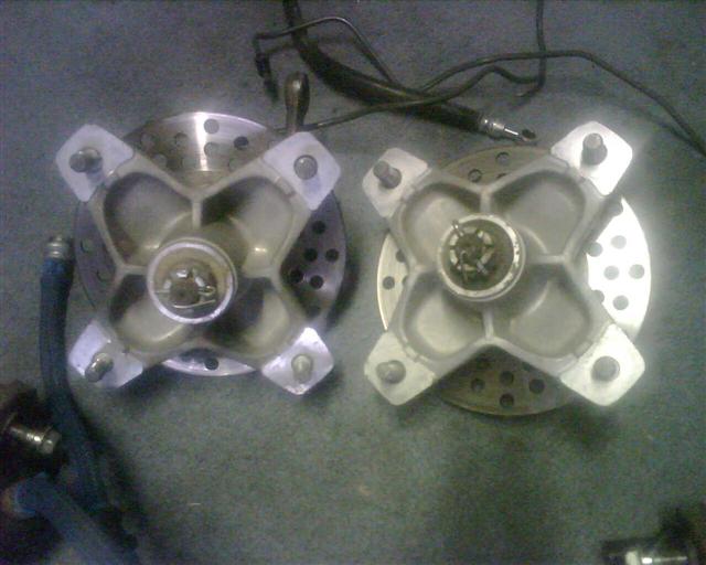

  2. I just found a picture i took installing the yfz spindle's from the stock banshee ones on my arm conversion-can you tell what side has all yfz parts ? haha

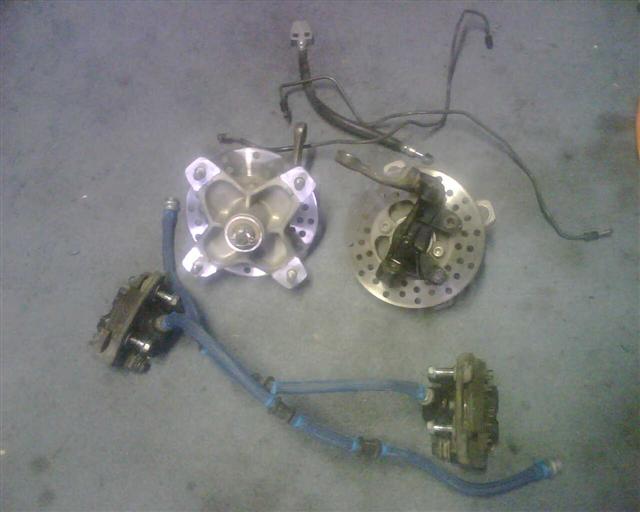

  3. Score-that is a smoking deal so far. i started my conversion using the banshee spindles and wasn't happy with the travel so picked up a set of spindles/rotors/hubs from a yfz and was much happier gained 3-4 more inches of travel (over 11" total now)and just rides better. i ended up using tierods from nossmachine. think they were in the $30 range and he makes them specifically for the swap. http://www.nossmachine.com/yamaha_atv_parts.htm

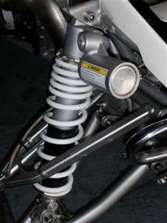

  4. I have been running a set of '08 ltr shocks (08 are valved slightly different)for a while with my conversion and i am extremely happy. they are a little tricky to get in there and do require some grinding on top mount of frame and some spacing on the bottom but over all well worth it imo.here is a couple pictures of mine.

  7. I have my stock front spindle,hub,rotor,pads and calipers with all the brake lines for sale. asking $75 shipped in the us Thanks
  8. Shipping will be about $25 but i will let you have them for $60 shipped. Thanks

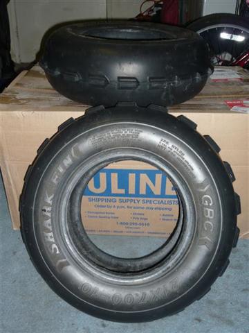

  9. I have a almost new set of gbc 21x7x10 shark fin front tires. they have about 3-4 trips on them and are in excellent condition with nipples still on them. $40 plus shipping or can be picked up in San Diego.
  10. Sorry but would like to sell in states. Thanks Got it and replied. Thanks

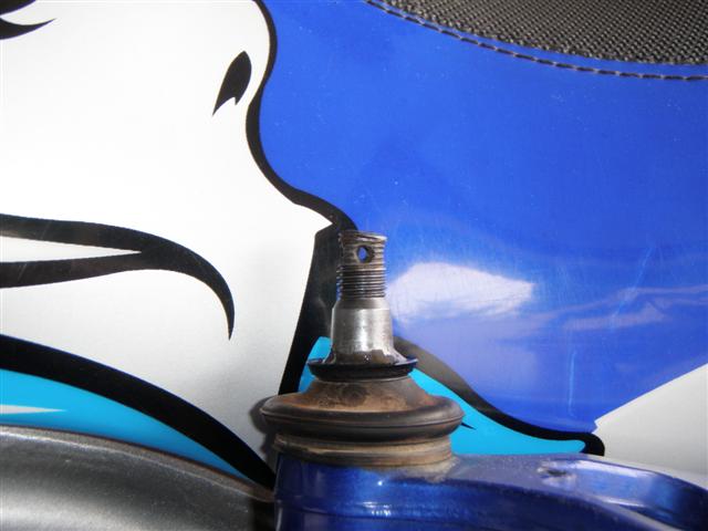

  12. This is about the best picture my camera will take, they all are about the same it's just the top 3-4 threads on all four but from the center of hole for the cotter pin down they all appear to be good. Thanks
