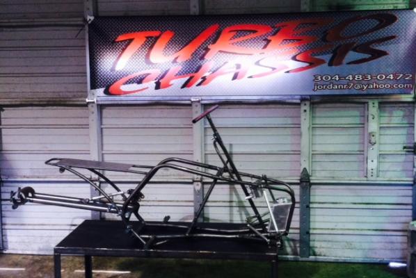

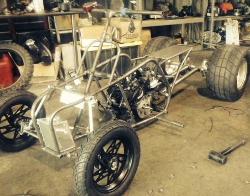

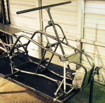

Turbo Chassis Posted May 22, 2014 Report Posted May 22, 2014 I have had several asphalt customers wanting me to make a stock appearing full chromolly frame for banshees, It took me way longer than i had wished to get this under way but never the less i finished my first one not to long ago, and will be starting on my 2nd soon for another customer. When i cut a stock chassis and modify it with subframe etc they get down pretty light compared to stock, but this setup will save the hassle of cutting and grinding and still ends up coming out lighter than a cut up stock frame. Before everyone asks this one wasnt "super duper light" it is lighter, the chassis setup came out to 20lbs and with swingarm a arms stem gas tank water tank struts bolts brake pedal etc it came to 46 lbs. I know how to save some weight and plan on the lighter ones coming in around 39 lbs but the motor thats going in this bike is pretty stout (as in really stout lol) and i didnt want the thing twisting up. weight is very important but you cant run good times or win races not going straight either. 1 Quote

special06shee Posted May 22, 2014 Report Posted May 22, 2014 Nice work! Looks bad ass in roller form. Love those spindle mounts. Quote

Turbo Chassis Posted May 22, 2014 Author Report Posted May 22, 2014 224 lbs ready to race wheelie bar, water, alky and all 1 Quote
Turbo Chassis Posted May 23, 2014 Author Report Posted May 23, 2014 These things are cheaper than people think.... I'm gonna have to raise my price just based off the reactions I'm getting when I tell the prices lol..... Frame, Swingarm, steering stem, front end, wheelie bar, brake pedal, bolts, gas tank, water tank, seat pan 2600.00 plus shipping plus powdercoat Quote
