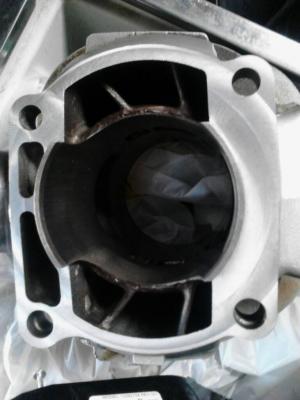

Porting cyls w/ racelogic template and 4mil short rod
OK, I need some schooling here. What´s wrong with those numbers? (194/130)
My opinion is, if that´s a gas motor, I wouldn´t go over 32bd(nor 194exdur) at first. You can always take them off and raise the exhaust later IF needed.
I did that mistake and went up to roof with 35bd with pump gas, and believe me the powerband sucks for a heavyer rider.
Right now I have 110% overported door stoppers and I hate them.
But anyway, you´re doing good work!!
i cant say with certainty anyhting is wrong with them numbers. put the engine together and try it would be my suggestion. if it dont run as expected then go to plan B. anybody thats done their own porting will likely have a few cylinders laying around that didnt work out like they planed. got a couple doorstops myself
but i would try to look past just a timing number though. heres the reason why. you said you wouldnt go past 32bd but how wide is the port and whats its shape and is there aux windows. lets assume you have a stock cylinder at 194 exh and 60% wide and 120mm roof radius. youll have X amount of bd area. now if we have another stock cylinder at 194* 100mm roof radius and window is 70% wide youll have more bd area, add aux windows and youll have even more bd area. so even though both cylinders have 194exh and 32* bd, one of the cylinders would have a shit ton more bd area. if you read some of the books they talk about angle area and time area and stuff like that .

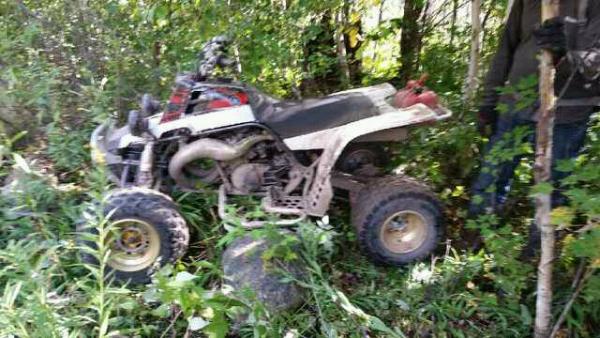

Finally got to ride the trails, and get a good run in over the weekend. Still needs some tuning done, and the domes worked a little. Overall I'm happy with how everything turned out. The bottom-end didn't improve much, but mid to high has improved greatly! Especially the transition. It used to hit really hard when the pipes came on, but now its a lot smoother. I haven't kept the throttle pinned for very long, I just know it tops out a lot faster... even after dropping a tooth in the rear.
So for now I'm going to address the domes to correct the squish and compression. After that, put the 34mm carbs on and get'em jetted. The only thing I might do after testing the larger carbs is widen the exhaust a little more. But so far there doesn't seem to be a need for it.
I did manage to get tossed twice. First time I slid off the trail and hit a rock, the 2nd time was on asphalt sliding sideways and it bit in.

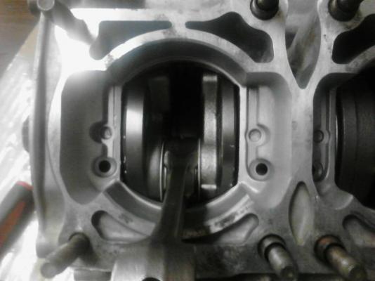

Here's a shot at the bottom of th WR transfers
its a shame they didnt put any aux ports in there. they really help alot especially if theres enough material to make them large. i built one last summer but never could get it to run right. was using a cr500 lectron needle from packard but i dont think it was the right one i needed. did alot of tuning and got it sort of running decent on the dirt but soon as it hit sand with a paddle the fuker kept stuttering. turned the needle and powerjets every which way but never got it sorted out. have another cylinder for it im gonna port real soon
Damn I missed that second crash, lol.
