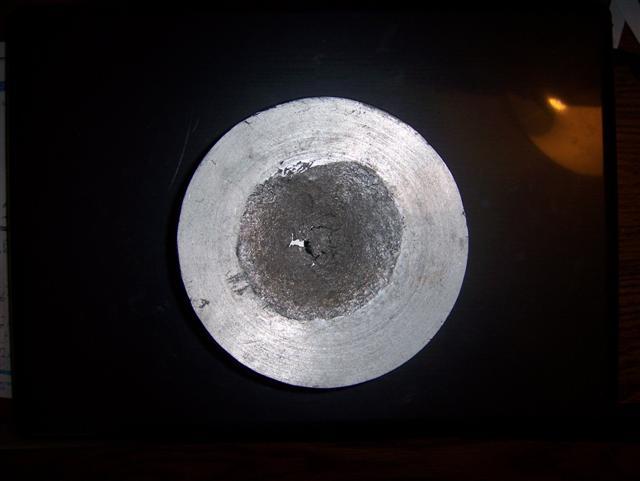

SlowerThanYou Posted January 21, 2013 Report Posted January 21, 2013 After drinking numerous Miller lights at my Sponsors hangar/shop. I decided I needed to build a new sand wheelie bar wheel. My sponsor (Al) asked me what I wanted to build it out of & I said Miller Light beer cans. So, the drunken idea was born. First off for the product review of the beer. Miller light is not my beer of choice, but it's free so it will have to do. Anyway, now to the building of the new product. A new 2 piece beer can aluminum wheelie bar wheel & tire combo. So, about a month ago we fired up the small kiln in the shop to make a couple of beer can ingots. After melting 1,000 plus Miller Light cans we have one ingot. Hence, we had to repeat the process again. I think we drank some beer that day. We end up at the end of the day with (2) 6" dia. x 6" long cast beer can aluminum ingots. The first picture is the ingot shown from the top with a rough end cut. I wish I had step by step photos of the process, but I don't. Quote
