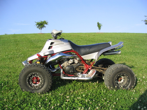

bansheejoel Posted February 26, 2010 Report Posted February 26, 2010 Well ive been looking at a set of rocket pipes for a while now and the guy says there the old style but i dont know what the difference is. Can anyone tell me what to look for so i dont end up with the newer junk rockets? Thanks Quote

locogato11283 Posted February 26, 2010 Report Posted February 26, 2010 the main differences in the older style and the new were the silencers. notice in the first pic below how the end of the silencer flares? thats the older style. then the next pic it doesnt? thats the newer style way back then i upgraded to the newer style silencer, but the expansion chamber didnt change. also, when people say the new ones are "junk" they dont really even know what theyre talking about. at one point in time there was a guy making them that put down some shitty welds on them. its plain and obvious when looking at them. if you find a set that has good looking welds, then there is nothing wrong with them. Quote

locogato11283 Posted February 28, 2010 Report Posted February 28, 2010 you ever think about having a personalized seat cover with the BHQ logo made for your shee? that would look good! haha, yea ive thought about it. i just dont wanna gay it up.. What about the thickness of the metal and the quality of chrome? Are the new ones as good as the ones I got? ive never heard of any thickness issues. theyve gotta be a certain thickness im sure. it was never an issue to my knowledge though. the welds were crappy on the old ones but the newer ones suck in my opinion. ive had both the welds on my set and my brothers were great. bbcmudtruck has my brothers old set and theres not a thing wrong with them. ive not seen a brand new set by these new owners so i have no way to tell. Quote
trickedcarbine Posted February 28, 2010 Report Posted February 28, 2010 There were some shitty pipes put in the mix because the original owner had farmed out work, then eventually sold off the company. There is currently a BRAND NEW owner, but they are working out a deal to get new dies for stamping, and will be producing new pipes. From what dave at rocket has told me many of the remaining pipes they have are just reworked or fixed pipes that the last owner had sort of hacked. Just find a set that fits right, and has clean welds, and buy that shit! You will never regret it. Also the main difference with the new owner is that the head pipe to stinger flange is changed so that any standard banshee clamp will work. Quote
