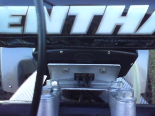

jbooker82 Posted March 18, 2009 Report Posted March 18, 2009 I run one. They come with a cheap plastic clamp that goes around the bars. I would recomend getting trail tech's dashboard/protector. That is what I run. It keeps it very well protected. josh Quote
evro Posted March 18, 2009 Report Posted March 18, 2009 i got one in december but havent really had a chance to use it on a good ride yet (still too much snow yet). it was easy to install, and the speedo calibrated very easily. i made one measurement, set it, then ran it and compared it with GPS. it was out 2 km (1.2 miles)@ 60 kph (37mph), which is damn close. i wanted the tach and temp gauge more than anything but all the other features made it a good buy. the factory mount is cheap plastic which could break very easily. i like volfans mount...simple, effective, and inexpensive. trail tech wants as much money for an aluminium (billet?) shroud as they do for the computer itself which is fuct. it may only be like that here tho cause getting shit in canada is more expensive. if you like gauges and digital instrumentation, i'm sure you'll love the vapor dude.... Quote

vulvafan537240 Posted March 19, 2009 Report Posted March 19, 2009 Just got it in today, instructions arent quite clear, which wire did you tap into for the power? also anything else i need to know?? tricks? hints? etc...... water temp guage is straight forward, speed sensor how did you mount the bracket and sensor etc? thanks guys for the help. i tapped into the yellow wire under the gas tank going to the dimmer switch. make sure you put the temp sensor in the hose coming out of the head so that it doesnt read the temp after the radiator has cooled the water. as for the speed sensor, i tried to bend the supplied bracket as told in the instructions, but i wound up breaking it so i cut my dust shield and mounted it there since i dont use them. Quote

evro Posted March 19, 2009 Report Posted March 19, 2009 i tapped into the power wire the same way volfan did. i tried to bend the speedo mounting bracket too with little success, almost breaking it as well. i applied some heat and got it to bend just enough to be able to use it but i did have to use a drill to expand one of the mounting holes a bit so that it would fit. be careful installing the magnetic bolt on the rotor. the instructions say 10ft/lbs and when i hit 8ft/lbs, the head snapped right off. i used jb weld to put it back together and it seems to have worked. my advice is to be generous with the locktite, and easy on the allen wrench...lol. i wrapped the tach lead 10 times and it would idle around 1350, but it would spike to 2200 on the gauge (only on the gauge though because the engine was maintaining a steady idle) every 4 or 5 seconds. the advice i got from volfan was not to wrap the lead, but just run it parallel along the plug wire and e-tape it up. haven't had a chance to do that yet, but i plan on trying it this sunday when i get a chance to work on her a little bit more. when i test ran it two weeks ago i was using a set of small 19 inch tires up front (thats what the last owner had on it, not my choice for sure) but i switched over to my 21's last weekend so i'll have to re-calibrate on sunday also. not too worried about that though, cause like i said before, i found it really easy to calibrate when i had the gps to correct it. Quote
