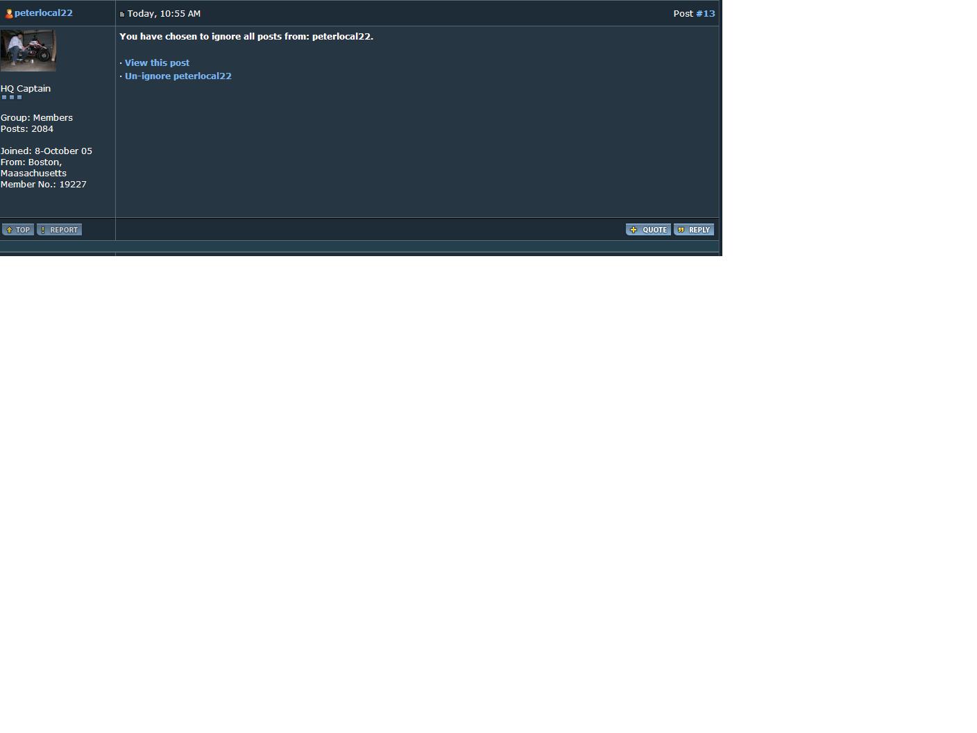

SAVAGE420 Posted March 2, 2009 Report Posted March 2, 2009 great write upshould b a sticky WHAT IN THE FUCK? Your hilarious man..... Quote
J.J. Posted March 2, 2009 Report Posted March 2, 2009 WHAT IN THE FUCK? Your hilarious man..... Yeah that's funny Quote
