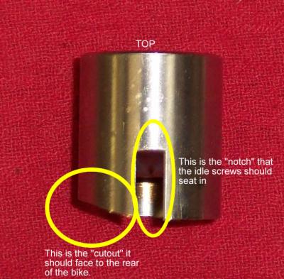

NitroTate Posted October 14, 2008 Report Posted October 14, 2008 I took a look at my slides, and they have the cutout facing the rear of the quad. I do know that when I adjusted my carbs by the little eyelette on the carbs and you match the little black piece, it seem like it ran alot better, and i know its still not perfect. So I am hoping that it takes care of that when I sync it. Is there anything else that I can check? Should I do a pressure test on the banshee? Also, another question, I bought the clamp on outerwears k&n air filters for stock carbs, that eliminate the airbox, will I have to rejet with those? Definitely get them in sync first. does it run well enough to go out and do a plug chop? As long as you are sure your not dealing with an air leak or something. Pull your plugs right now and see how they look dark or light. As far as the filters, make sure they are not oiled too much. To answer the question about jetting, more air means a need for more fuel but I wouldn't change jets until you really know where you are at to begin with so do a plug check. Quote
