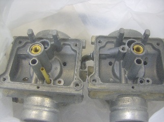

jjn56 Posted September 17, 2008 Author Report Posted September 17, 2008 Took my carbs off and I am going to put in my Idle screws today (I found them), take a look at this picture, the left carb has a brass tube about 1 1/2" long sticking up and the right one doesn't. Is this how it is supposed to be or should they both have one? Also the needle valve seat (pointed rubber part) had a slight indentation, would this cause a fuel leak and should I replace them or just clean them and put it back together. Quote
shee4speed Posted September 17, 2008 Report Posted September 17, 2008 The brass tube is normal.Just clean those up and put it together and if it leaks you need to replace those needle valve seats. Quote
