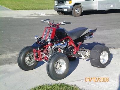

714banshee380 Posted January 24, 2008 Report Share Posted January 24, 2008 I got mine precut from maier they are the race cut front fender I like the way they look. I tried cutting my old fenders just used a jigsaw with some 600 grit to smooth it out.... they turned out alrite but th epremade race cuts come with a little flare out and it looks like they were never cut Quote Link to comment Share on other sites More sharing options...
