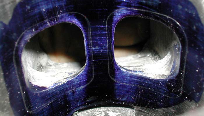

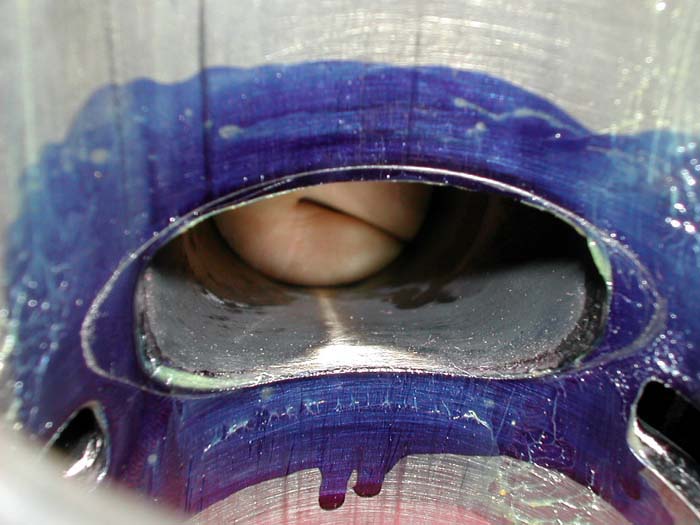

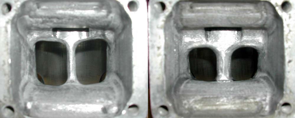

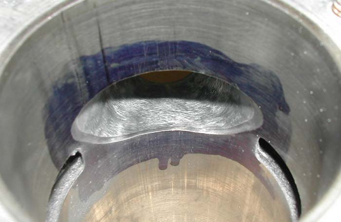

Stinger Posted January 14, 2006 Author Report Posted January 14, 2006 (edited) i could help yo u decide alot easier if yo u knew your actual exhaust and transfer timing numbers after its done being ported ,but youd probably be ahead to run dual 33 pwk s or the bored out 30mm kehein pwk's ,the stock carb limit is probably around the high 70's RWHP on gas ,but i nall actuallity you wont be any where near that limit so dont be too concerned . 459414[/snapback] Looking at what's been said so far I don't think the stockers will be hurting me too much just yet. RaceLogic doesn't publish the timing #'s and I don't have a degree wheel to check them (Maybe I can get Jeff to do it?) but here are some pics of the port work. The exhaust port was raised about .010-.012" and the transfers will get the same unless Jeff thinks something else will work better. These two show the amount of material to be removed: These two are the semi-finished ports...I still have to bevel and smooth a bit more after it gets bored/honed. First set is a before and after comparo: Edited January 14, 2006 by Stinger Quote

rocketboy Posted January 15, 2006 Report Posted January 15, 2006 (edited) my honest 2 cents is your intake looks decent, the exhaust is all wrong IMO ,its is too wide and low ,the shape isnt ideal at all . the height is pretty wimpy even for FMF pipes ,the intake accounts for very lil power making propertys ,the transfers and exhasut wil l m make the bulk of your added performance gains . Edited January 15, 2006 by rocketboy Quote
Stinger Posted January 15, 2006 Author Report Posted January 15, 2006 my honest 2 cents is your intake looks decent, the exhaust is all wrong IMO ,its is too wide and low ,the shape isnt ideal at all . the height is pretty wimpy even for FMF pipes ,the intake accounts for very lil power making propertys ,the transfers and exhasut wil l m make the bulk of your added performance gains . 459606[/snapback] The exhaust gets wider as it gets to the top, even though in my pics it looks like the widest part is centered on the port (because I can't take a pic straight at the port). Here is a pic of the actual exhaust shape: Quote
fastbanshee4u Posted January 16, 2006 Report Posted January 16, 2006 I would raise exhaust to 27.5 t0 28 mm, change domes to 19 or 20s to get back some compression.Keep the top of the exhaust port arched nice to keep ring and piston wear down. Mic the diameter of the inside of your head pipes and try to get the cylinders close to that. Use a drum sander in a diegrinder,then blend that to the cylinder edge with paper wraped around a dowel rod or dremel flex shaft..Get your exhaust real smooth.Dremel makes sanding/buffing wheels that work great,brown first then the grey one. Yes, on your cases just taper to match the the cylinders. Match the gaskets also or buy from Twister racing. Get used to spinning or buy a 4 stroke,also Fattys hit hard and spin easy. Good luck Quote
