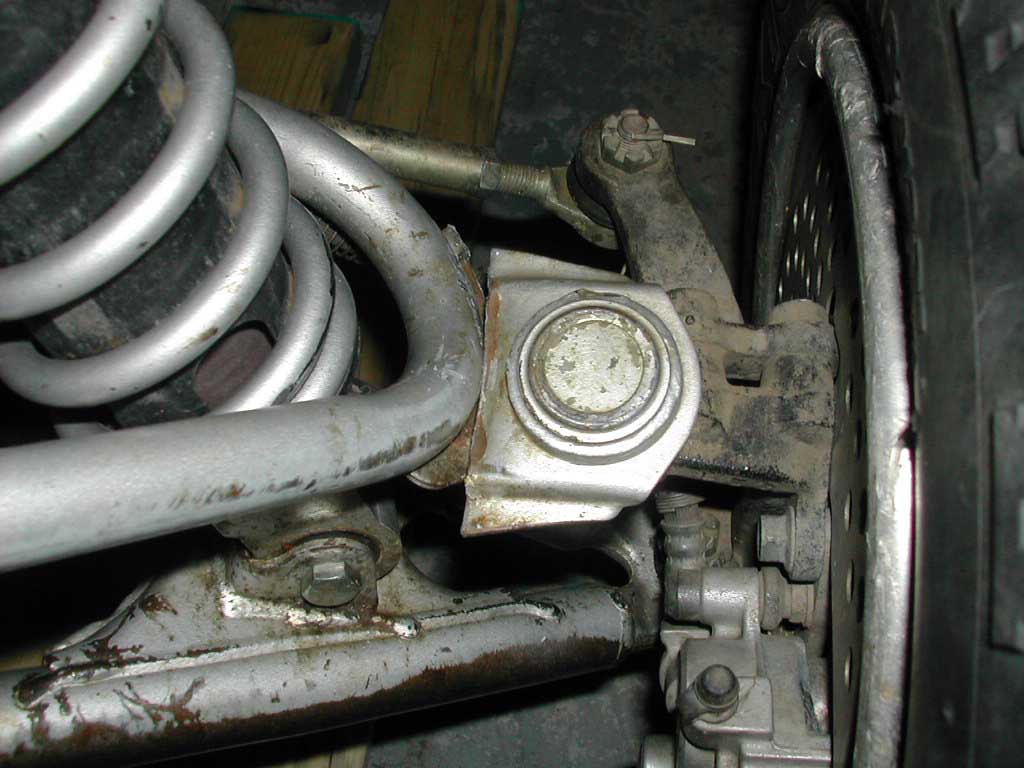

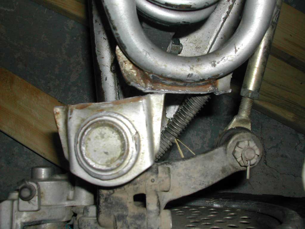

Stinger Posted October 8, 2005 Report Posted October 8, 2005 I was going over a small jump that throws me about 20 feet in length and 3-4 feet high...after about the 10th jump I heard a loud snap...I looked down and my wheel was flopping around and the upper a-arm was broke. I set the arm back in place and limped it back home about a mile... I was planning on a trip to Little Sahara in the next week or two...now I need to figure out what I'm going to do about this arm so I can still make it. I could weld it no problem but I have a feeling it will just break again if I do that. Worse case scenerio I may weld it and put a bunch of extra gussets on it to make it strong (and ugly) just to make the trip. What do you think, should I buy some +2 arms or should I just pick up a set of used stockers? Who makes some good budget aftermarket arms that I can get asap? Anybody got any used aftermarket arms they'd be willing to let go of for a fair price? Here are a few pics of the break: Quote

Justintoxicated Posted October 10, 2005 Report Posted October 10, 2005 If It was me I would weld it up (with gusset) and start looking at aftermarket +2 inch, cause your going to need shocks to go with +2 A-arms... Quote
locogato11283 Posted October 11, 2005 Report Posted October 11, 2005 im with justin..id weld it up for now with a gusset and then look for some arms.. Quote
fast500#12 Posted October 11, 2005 Report Posted October 11, 2005 when you get your new ones keep on top of the rust and cleanlyness looks to me like rust made the weld weak. Quote
