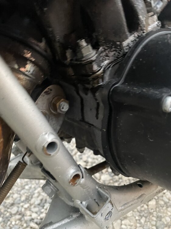

4 hours ago, marktorres2000 said:
I’m having the same problem oil is coming out my rig jug more than the left in the front but my bike runs fine I put oil in it every time I’m done riding 7444C7A4-3E50-4CC0-BEA9-3B5C535477EA.thumb.jpeg.fce00ba4436918ad5f601bca9e424cd9.jpeg
The oil is seen on the side to seem like a base cylinder but that’s because I ride my banshee on 2 wheels most of the time / wheelies
