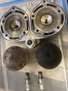

spark plugs started working themselves out, checked compression after build had  150psi after 5 hrs on new engine have 80psi. Pistons and domes are ruined cylinders are still good. Here are pics. What did I do wrong? Don’t want to get new parts and have this happen again. Oh and running ethanol free premium, should I have been running race gas?

what is your squish, what is considered “premium” where you are at? What is your jetting and elevation?
 Also….. the piston on the right….. is that a hole melted through the top of the piston?
