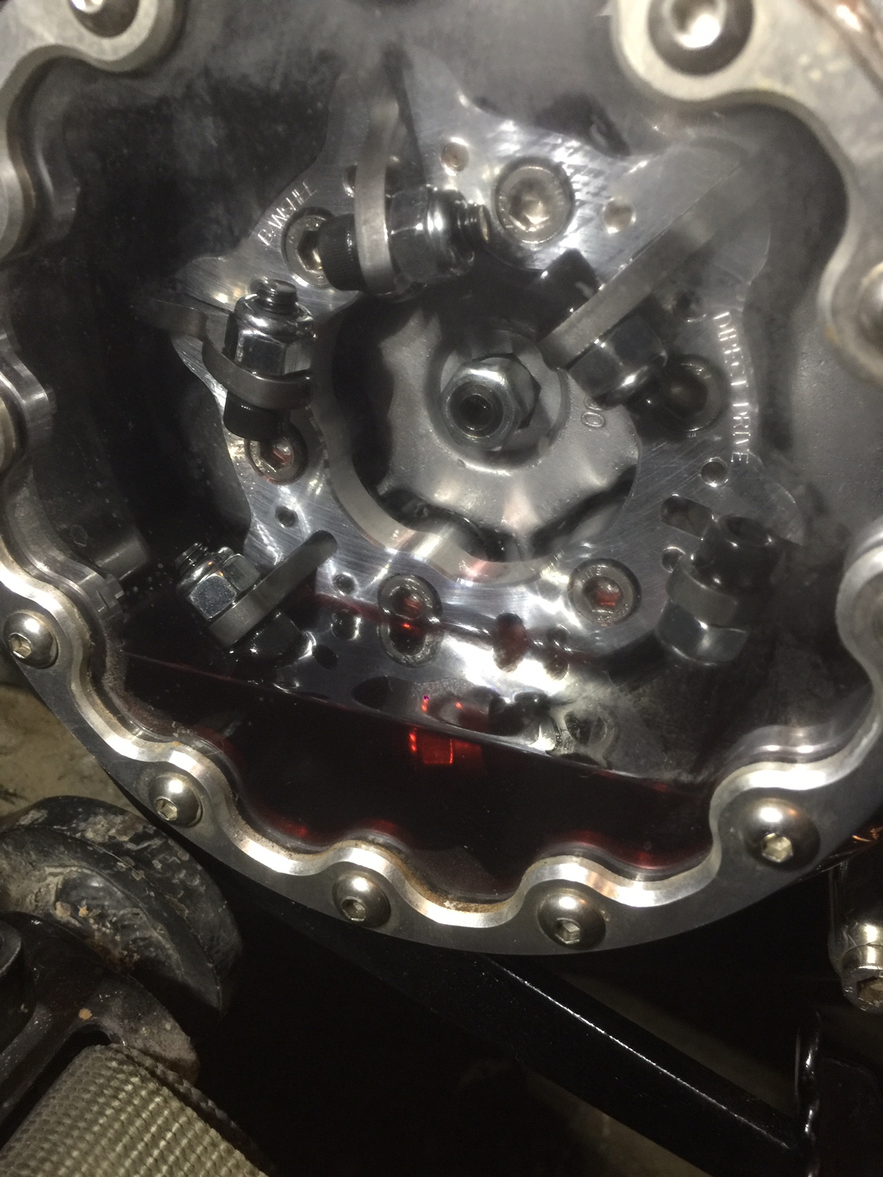

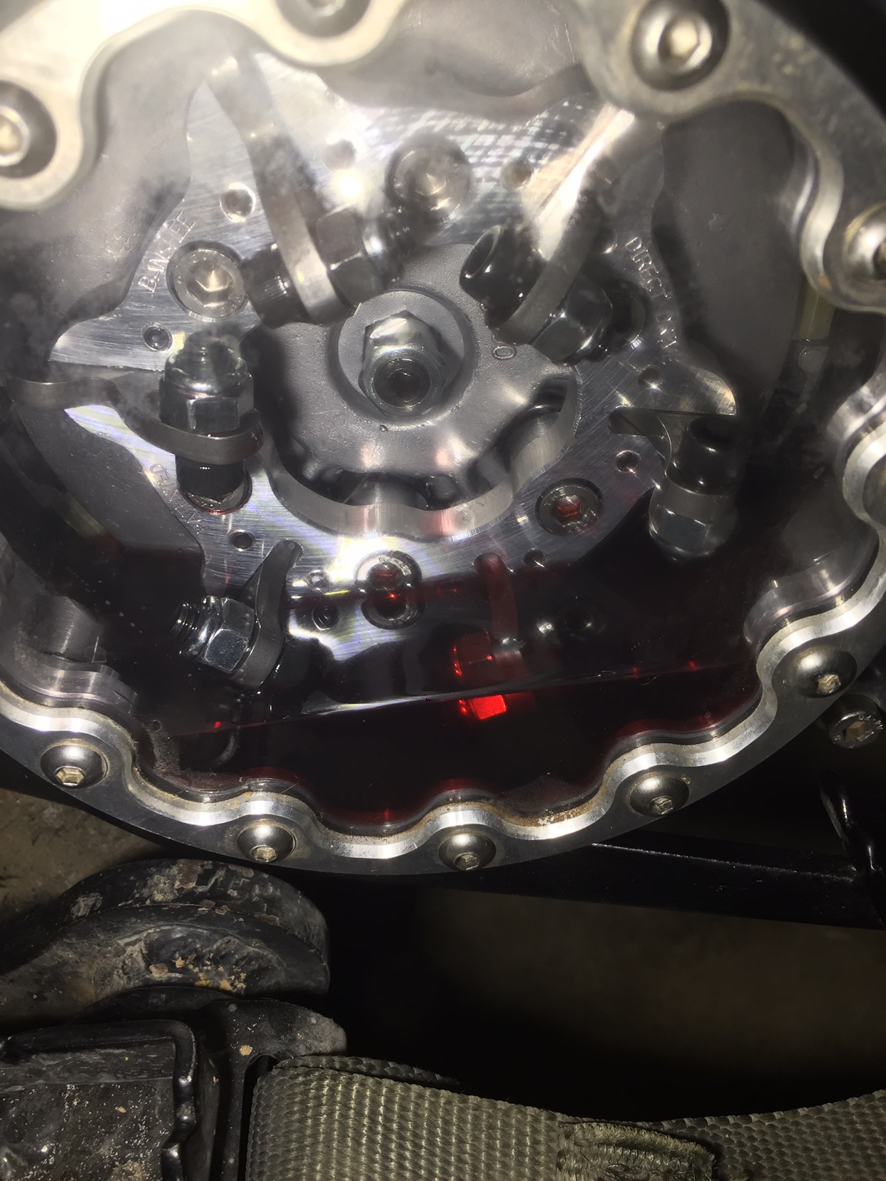

Ynotsmith69 Posted November 6, 2018 Report Posted November 6, 2018 My engine is mostly new I sent it to Herr juggs over a year ago rode it a few times and it’s sat since then.. when I got it back going I noticed when I down shift while holding the clutch at a higher rate of speed I hear metal grinding or something until I’m at low first gear speeds. It runs excellent for now and shift through all gears. I think it could be the shift shaft or the shift star but I’m not sure . The engine has new 4mil long rod crank Athena cylinders wiesco pistons noss performance head dune 1-5 neutral on bottom new heavy duty clutch and lock out kit . Sent from my iPhone using Tapatalk Quote

Ynotsmith69 Posted November 6, 2018 Author Report Posted November 6, 2018 Thanks... unfortunately I just changed the oil luckily I have the clear case so I can see right in I was also thinking something happened with my lockout kit last time I rode it and this first happened it looked like my lockout kit was loose or something and I didn’t install it so I don’t know how it’s suppose to look on it. I’m gonna post a picture Sent from my iPhone using Tapatalk Quote

Ynotsmith69 Posted November 7, 2018 Author Report Posted November 7, 2018 Anyone got a picture of what the lockout kit should look like installed ... I feel like the arms on mine got loose and slapped the glass last time I rode it... Sent from my iPhone using Tapatalk Quote
Ayesully810 Posted November 7, 2018 Report Posted November 7, 2018 (edited) You won’t know unless you take the cover off!!! Just drain the oil into a couple bottles and re use it. I’ve done it many times. Same with coolant I re use that crap all the time. If your arms were hitting the cover I’m pressure sure you would have some marks on the inside of it Edited November 7, 2018 by Ayesully810 Quote
special06shee Posted November 7, 2018 Report Posted November 7, 2018 Lock out arms are supposed to be “loose”. Pull the bitch apart and then ask question if needed. If your clutch basket is worn bad it will chatter and that maybe the noise you hear. It has nothing to do with your shift shaft or shift star. Something else is going on. 1 Quote
