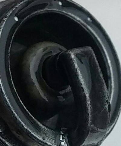

antd913 Posted March 13, 2016 Report Posted March 13, 2016 Ok so her it goes .... 01 banshee never seen it run baught it and put everything listed bellow into it .Torres removed , brand new 28mm pwk flat slide carbs main jet 150, pilot 45. I ride at sea level . noss cool head with 22cc domes. Comp is 133 and 134 . t5 exhaust . Air box removed k&n style air filters . went through electrical system all seems to ohm out within spec .went through the wireing harness . spark is blue . reeds are new carbon fiber reeds. Top end is new . when I kick it over it's tries to start and won't even idol and if I give any throttle it bogs right out . after 2 or 3 times of trying I pulled the plugs and they were wet with black\grey crap on them . Any help you guys can give me would be greatly apreciated . Quote
antd913 Posted March 13, 2016 Author Report Posted March 13, 2016 It was a brand new NGK br8es. That's after it trying to start 3 times . Quote
antd913 Posted March 13, 2016 Author Report Posted March 13, 2016 It cleans right off and looks like that again after trying to start 3-4 times Quote
hoppedupandcutdown Posted March 13, 2016 Report Posted March 13, 2016 It cleans right off and looks like that again after trying to start 3-4 times But a gas fouled plug won't fire again. And only half-assed with a cleaning. Quote
antd913 Posted March 13, 2016 Author Report Posted March 13, 2016 I will pick up a fresh set of plugs and see what happens . i personally think it's deeper issue than that but i will thrilled if fresh set of plugs does the trick . Quote
n2otoofast4u Posted March 13, 2016 Report Posted March 13, 2016 Have a buddy press his finger over the plug hole and kick it. It looks to me like the bottom end is going to have a ton of fuel it it. If it sprays fuel, or even a mist with the finger trick I'd pull the pipes and reeds off and let it air out. While you've got the carbs off give them a good clean and look over then connect a purge bottle to them and be sure the floats are set correctly and not leaking by. 2 Quote

guns4children Posted March 14, 2016 Report Posted March 14, 2016 Pull the plugs and let everything dry out. If you push the throttle once or twice before you kick it then it should be fine to start without throttle just the carbs chocked. Quote

antd913 Posted March 14, 2016 Author Report Posted March 14, 2016 How long should I let it dry out before giving it another try ? Quote
sheerider11 Posted March 14, 2016 Report Posted March 14, 2016 How long should I let it dry out before giving it another try ?pull plugs pipes intakes reeds and kick it over a few times then let it sit. Gas evaporates pretty quick. But I'd leave it a few days if the bike is indoors. You know it'll all be gone by then. Is it holding you up in anyway while it's down? Quote
