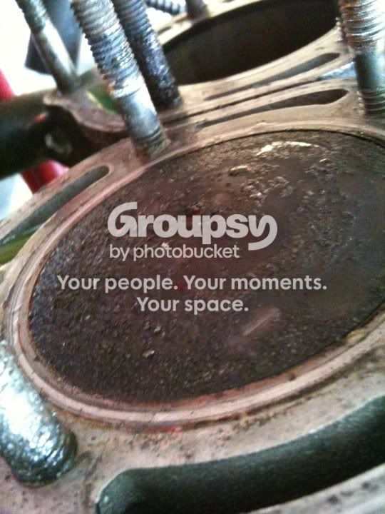

ELKARACING_SHEE Posted August 22, 2010 Report Posted August 22, 2010 my left piston is full of carbon on top, and its kinda bubbly, or something that is a pic of what it looks like. How can i clean that safely? i mean not to do any damage to the piston, or scratch it. Any help is greatly appricated Quote
madjimmax Posted August 22, 2010 Report Posted August 22, 2010 Unless you completely disassemble the top end I dont think I would try that on the bike. I wouldnt want that shit getting between the piston and the cylinder it will sit on the ring and could scratch the shit out of your cylinder. It will probably fall in your water jackets and could clog a core in your radiator. But if you must do it I would say do it with a wire brush and a shopvac. Just be easy with the brush and make sure the shop vac is on at all times so you are sucking up everything as it comes off. If it was me I would just take off the cylinders pull off the pistons and clean everything up. Just take your time and remember that when doing engine work always make sure bike and work area is always clean, sand and bearings dont get along at all. Good luck Bro and let us know everything turn out Quote
ELKARACING_SHEE Posted August 22, 2010 Author Report Posted August 22, 2010 thanks, but i dont think im going to take the cylinders apart. I have a shop vac, and where the radiator wholes in the cylinders, i have stuck paper towel in there, in which nothing can go in there Quote

Vintage Smoke Posted August 23, 2010 Report Posted August 23, 2010 Haha, Elka knows all about using butter on banshees. Well in that case laquer thinner works very well. It really soaks into the carbon. A little elbow grease with a scotchbrite pad along with the thinner will really clean things up. The thinner softens it up very well. You are taking chances cleaning it up while the cylinders are still in place though. If the head is already off it will only cost you a set of base gaskets to be able to clean everything up right. Quote
jbooker82 Posted August 23, 2010 Report Posted August 23, 2010 Ethrie way I would have pulled the drain bolts out of the side of the cylinders so antifreeze didnt get spilled down into the crank case. Quote
Larry's Shee Posted August 23, 2010 Report Posted August 23, 2010 (edited) Sea Foam also disolves carbon , less flamable, doesn't evaporate as quickly. Edited August 23, 2010 by Larry's Shee Quote
madjimmax Posted August 23, 2010 Report Posted August 23, 2010 thanks, but i dont think im going to take the cylinders apart. I have a shop vac, and where the radiator wholes in the cylinders, i have stuck paper towel in there, in which nothing can go in there Bro its your ride and its whatever you want to do, But I'll just say that unless your willing to take care of your shit the right way. Its only ever going to be shit, you got yourself a nice bike and you should do your best to take care of it and it will take care of you. It would be 8 nuts and a base gasket come on elka dont half ass it you will only regret it later IMO. Quote
doorslammer Posted August 24, 2010 Report Posted August 24, 2010 why did you remove the head in the first place? and what type of oil do you use? and dont clean them in the cylinders, i've never heard of such a stupid idea. remove the pistons and use a wirewheel/wire brush. Quote
DiSkOe*1 Posted August 24, 2010 Report Posted August 24, 2010 are those big bore? look lil close to threads to be standard bore... DiSkOe*1 Quote
banshee67 Posted August 26, 2010 Report Posted August 26, 2010 why bother? it dosent make any difference plus ithere is always the chance of getting that crap in the motor itself Quote
