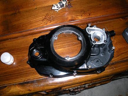

twizted269 Posted February 14, 2009 Report Posted February 14, 2009 even if they made the clear center caps, you would still have to cut and trim the material behind it. it is still solid after you remove the center cap. i have one made up like that but havnt used it. had an extra cover laying around and said why not? still unteasted for leaks though. Quote
JasonsBanshee Posted February 14, 2009 Report Posted February 14, 2009 DMC Banshee modified his stock cover and it works great with no leaks. Quote
JasonsBanshee Posted February 14, 2009 Report Posted February 14, 2009 I made mine 4 years ago and I never had problems even I do some hard shit with the shee :happy: First , cut the stock one and I use a 3/16" plexiglass and take the same 3 bolts to tight it and put a silicone joint , my cover has never leak with that method... Hope this help you Banshee_Bandit Quote
