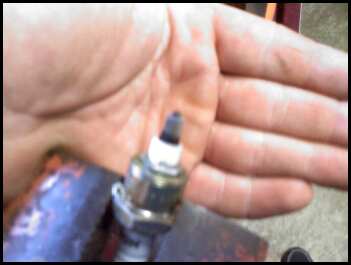

  12. 27.5 280 needle in middle I am running vf3's and +4 timing. Motor is stock bored 64.50 and a set of DMC 916's. Power seams good 1-3 then in 4th it hits a like standstill then all of the sudden picks up. Doesn't feel like a bog, more like a hold in the rpm then jumps up. Just add 3 hd spring to the clutch so i dont think its slipping.
  13. This is after riding for awhile.
  14. anything??????????????????
  15. Here is my plug chop. This is after riding for a while.
  16. Here is my plug chop. This is after riding for a while.

  18. Ok so I am running a set of DMC 916's, my jetting is 27.5 pilot 280 mains and needle clip in the center. I have a k&n filter and a set of vf3's, and +4 timing.Motor is bored to 64.50. Also i am at sea level. The bike runs great but seams to stop pulling hard in 4,5,6. Am I lean on the main? 30 pilot 280 main needle centered is the recommended jetting from DMC. They also say to use a 320 plus main with the powerpack that they sell, it uses a k&n filter. https://www.dmc-on-line.com/PDF/Banshee-916.pdf My plugs look like they are on the rich side after riding for a while. Any help here?????????????????? Thanks guys
