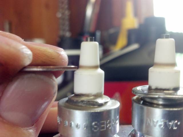

Did my first plug chop today on the new Dune/Play port from FAST. DMC 916 pipes, proflow with k&n no lid, 20cc domes 330 main, 27.5 pilot, Dynojet Needles 3rd from top out of 6 positions. Think I need to go up 1 on the pilot, have a bog off idle. The air screws don't have any effect until i go less then 1 turn in. At 1.5 the idle picks up slightly and doesn't get any higher the further you go out. The jet spec's that DMC calls out is a 30 pilot on a bone stock bike I assume, now I'm ported. What does every one think. Any pointers here are appreciated. Thanks BHQ
Ok so I down jetted to 340s and rode for 15 to 20 minutes pulled the plugs and they where slightly black. Not the washed out orange look. And no little watter drops. Yes there where some.
360 is what Jeff @ fast had me start at. Re-jetted today installed 340s. Didn't get to ride it. The plugs had tiny drops of water. thinking its just some condensation.

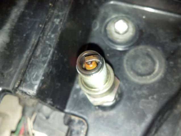

OK so I was riding last weekend on a long set of whoops down the train tracks when I stopped to let the other guys catch up, I noticed coolant leaking out the overflow onto the right pipe. Shut the bike off to check it out. Everything looked ok , bike didn't feel hot and there was about a 1/4" of coolant in the over flow. we whent to a small sand pit to race. Did 2 passes with my buddies. Smoked them both. LOL Bike got very hot feeling, but never leaked any more coolant, road the rest of the day 40 miles total. Today I went out to do some maintenance and noticed there was no coolant in the overflow. I pulled the plugs and they where wet looking and had a red or orange looking color. Also piston tops are solid black. My setup FAST dune/play port NOSS Head 20cc +4 timing stock carbs -tors 360 27.5 out 1.5 Dyno jet needle 4th from top
