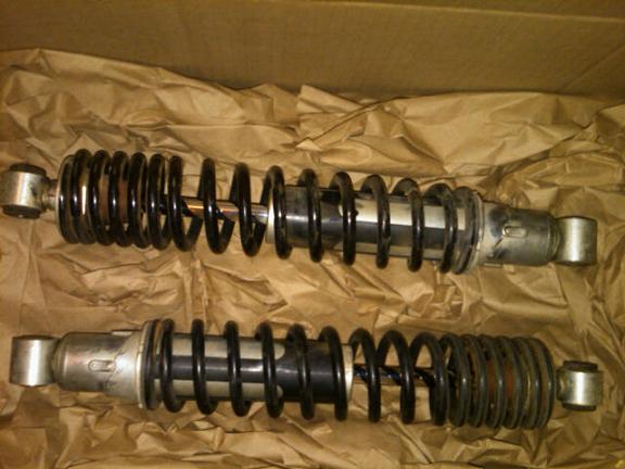

Stock arms and stock shocks
VooDooBanshee replied to VooDooBanshee's topic in For Sale - Parts & Accessories
Black stock shocks and arms for sale. No dust caps or bolts. Off a really clean 05 SE...Prices are shipped - pay pal. Shocks - $60 Arms - $60 Thanks!

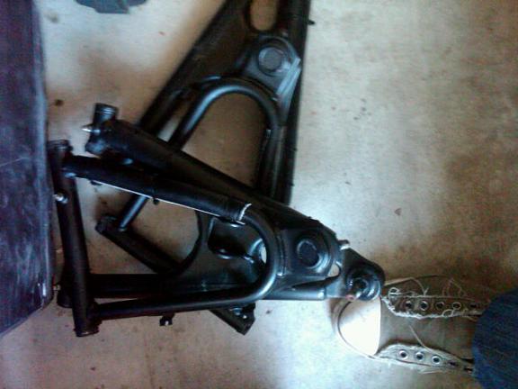

I have a set up like new stock a-arms for sales. No dust caps or hardware, but I did make guards for the fronts which will protect them. $80 shipped. Paypal...

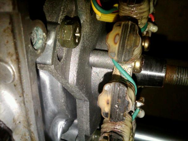

I guess I will buy a new fly wheel becuase this thing looks pretty bad... What about that stator? Looks like it took some of the coating off of the tops...
