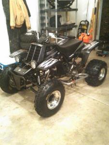

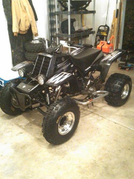

  17. Hi guys. Here is a picture of the new Banshee. 2005 Special Edition. Not the best picture, but wanted to post it up! Trying to make it the best possible trail bike...Any suggestions on what to do next? Motor is 100% stock with compression right at 120 PSI... Here is what it has so far. New ITP Rims on GNCC ITP tires K&N internal filter with K&N filter lid + outerware Toomey T6 pipes Full Skids T&M case saver Toomey Sparkies 6 Pack Rack Front Bumper. Cobra Nerf bars Now, I need some front shocks - Stock ones are crap!
