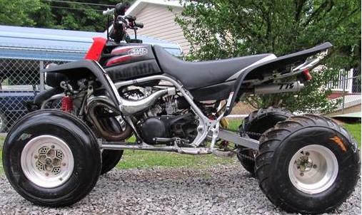

  2. Location: Pikeville, KY Contact #: 606-434-9165, call or text.. preferably text Reason for selling: Laid off Price: $2,250 firm. Plastic has no bad scratches or stress marks. Frame is in great condition I have several pictures to email if requested, email: [email protected] I don't have access to tinypic right now or I would use that. Up for sale is my 2003 Yamaha Banshee. I am the 2nd owner and have babied this thing since day 1. It has been overhauled one time and I sent both cylinders off to Jeff at F.A.S.T for a fresh bore of .10 over on the cylinders. I put it back together back in November with brand new Wiseco Pistons, all gaskets, etc. I have maybe ran 10 tanks of gas through it since then. It has had nothing but Klotz gear oil for the tranny and Klotz r50 for the pre-mix at 32:1 (4 ounces to a gallon). It has brand new brakes, pivot bearings, chain, sprockets, brake lines, and the major mods listed below. I still have nearly all the receipts for this bike on everything i've done to it, I can provide those to you whenever you come to see the banshee or buy it. It's been well maintained, never abused, the reason i'm selling it is for the simple reason I bought a new cobalt, 2 weeks later got laid off, and I don't have a way to haul it anymore and college is starting back for me and I never get the time to enjoy it. I have well over 5 grand in this bike all together including buying it. Engine: .10 Over bore from F.A.S.T Wiseco Pistons NOSS Head stamped by F.A.S.T with 20cc domes (155 pounds of compression, runs on 93) Port cleanup with the exhaust side polished +4 timing VFORCE 3 Reeds PWK 28 swap, jetting to literally perfect.. it has never fouled a plug Uni pod filters New intake boots with crossover tube (a clean setup, not a ricey boost bottle that leaks) Toomey T5 Exhaust Billet Water Pump Oversized radiator (30% more capacity full of engine ice) Tires: (comes with 2 sets of rims/tires, one for sand drags and 1 for trails) -20x11x9 Holeshots (half worn out) -Stock front tires, could use new ones Drag tires: -22' Zippers BRAND new never used (on banshee in 2 pictures) -Sand front tires Suspension: Stock, Plus +4 Swingarm (brand new, about a month old)
