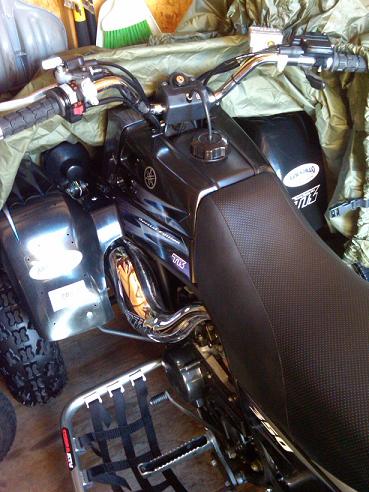

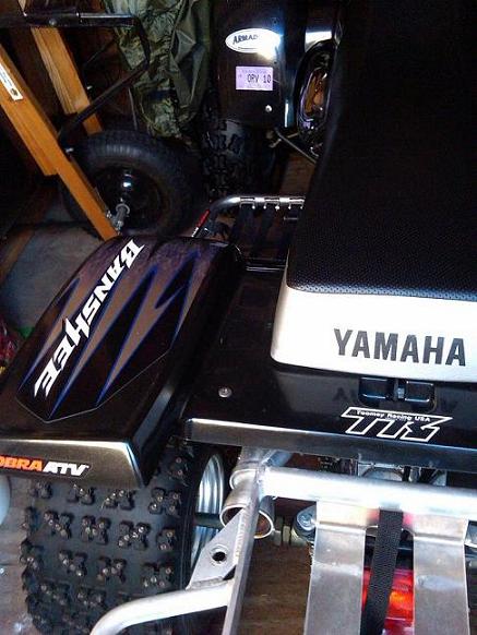

Whats up guys! Went out to do my weekly fire-up and snapped some pictures. Need to replace the needle and seat becuase the carbs are leaking, but damn - she's lookin good. Still have the ice picked tires on from the snow storm...
