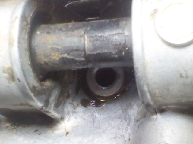

I was doing a leak down test, and in the process, tranny oil starting gushing out this hole on top of my engine, right were the back shock bolts onto the frame. I have pics below to what hole I'm talking about. I loose about 3-4 psi within 6mins. Do I have an internal leak? If so, where is it likely to leak air inside? I heard a keyway could leak, what else? http://s1179.photobucket.com/albums/x392/s_portrey/Adam/
